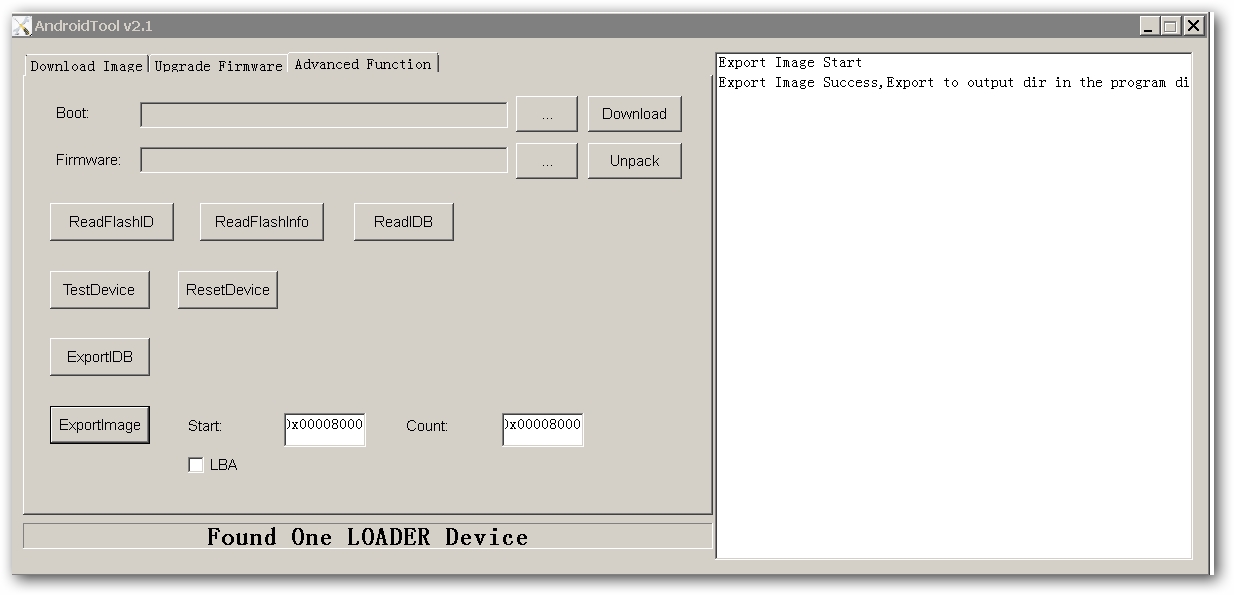

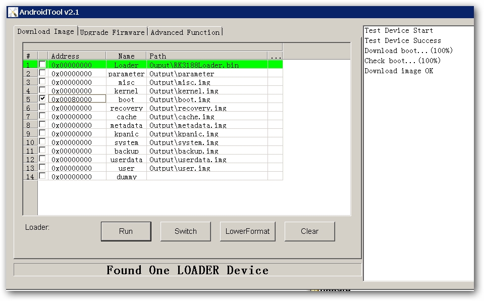

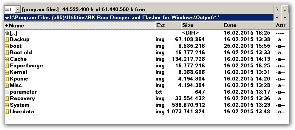

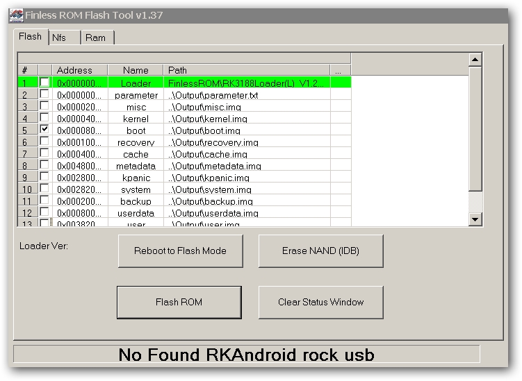

I continued to work on the problem, but unfortunately have had no success thus far. This is what I did:
I backed up the various partitions with the Android ROM Dumper Tool v. 2.1. I attach a screen print of the output folder. The existing boot.img (old) has a size of 16 MB.
After renaming it, I copied your “Icarus_boot1.img” (which actually is identical with the boot.img of the latest official firmware update) into the output folder.
I then marked the boot partition for download (see screen print) and got a success message.
However, if I check by doing another “ExportImage” it turns out that the boot.img has not been changed in spite of the success message.
Using the old “ROM_Flash_Tool_137.exe” as recommended by Bob in his detailed instructions is no alternative for me, as the Icarus device is not recognized by the program.
Any ideas what else I could try?
You have to install “Icarus_boot2.img”.
“Icarus_boot1.img” will not work in your device because it is a T61C.

Originally Posted by nightboy View Post
Check installed apps in Settings. If you could not find Root Master, then copy "Root Master 1.3.6_Cekas FIX.apk" to your device and install it manually.
Oh stupd me !!!
Everything is back to normal - or almost.
As an aside: Customer support at Icarus woke up and sent me a rescue package consisting of RK Erase Tool v. 1.0 and RK Batch Tool v. 1.7 plus an enormous new img file without warning that all personal data would be lost. Thanks heaven I had backed it up before.
So now: Sacks full of "thank you" for your valuable help. I learned a lot and this has wetted my appetite to get a bit more familiar with Android.
Cheers
