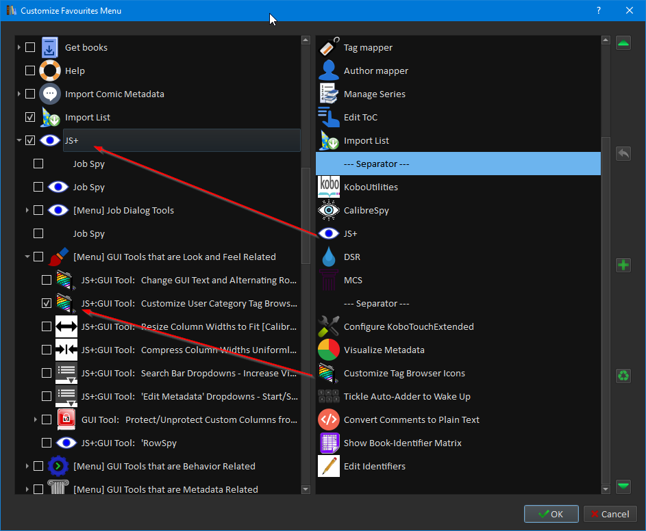

Favourites plugin issue, not LCs. I suspect that using it like you do was never explicitly supported many years ago when Favourites was created.
Old 11-24-2020, 11:45 AM   #242
ownedbycats
Custom User Title
ownedbycats's Avatar
Posts: 11,654
Karma: 81419259
Join Date: Oct 2018
I don't follow. I use it for menu items that don't fit on my toolbar and sub-menu items that I want convenient access to, which...is exactly what's mentioned in the original post.

You are adding LC in 2 places, as I said before.

I also have Job Spy and some of Job Spy's submenu items. They work. Kobo Utilities and Customize KoboTouchExtended too. It's only Library Codes that fails, and even if I only add a submenu item.
Name:	2020-11-24 12_55_31-Customize Favourites Menu.png

Join Date: Aug 2013
Location: Texas
Favourites plugin design issue, not mine. I am finished with this topic.
I just installed LC, briefly tested, and looked in the code. At the bottom of LC's version of common_utils.py, create_menu_action_unique() does this:
    # For use by the Favourites Menu plugin. If this menu action has text
    # that is not constant through the life of this plugin, then we need
    # to attribute it with something that will be constant that the
    # Favourites Menu plugin can use to identify it.
    favourites_menu_unique_name = 'Library Codes'
    if favourites_menu_unique_name:
        ac.favourites_menu_unique_name = favourites_menu_unique_name
Which explains why *all* LC menu options are named 'Library Codes'. Is that the intention? If so, why are different names passed in ui.py? I would speculate it was a bit of test code accidentally left in.
I've never delved deeply into how FM works, but it won't surprise me if it gets confused when handed a whole stack of items all with the same 'unique' name.

one line of code was deleted somewhere along the line
Actually, a unique name is passed by each and every menu action, but one final line of code was deleted somewhere along the line:
if not favourites_menu_unique_name:
That fall-through should never been executed, since a unique name is passed by each and every menu action.
Thanks for the catch.
I would suggest that a non-unique default value for favourites_menu_unique_name, even as a fall though, would be contraindicated.
If every action has a favourites_menu_unique_name and the fall through never gets used, it doesn't matter. Until it does. So I don't think I'd keep that fall through at all. favourites_menu_unique_name is not required.

Version 1.0.48 Favourites plugin accommodation.
Version 1.0.48 - 2020-11-24 Favourites plugin accommodation.

It works now!
Name:	2020-11-24 16_20_04-calibre - __ My Books __ Physical Books __.png
