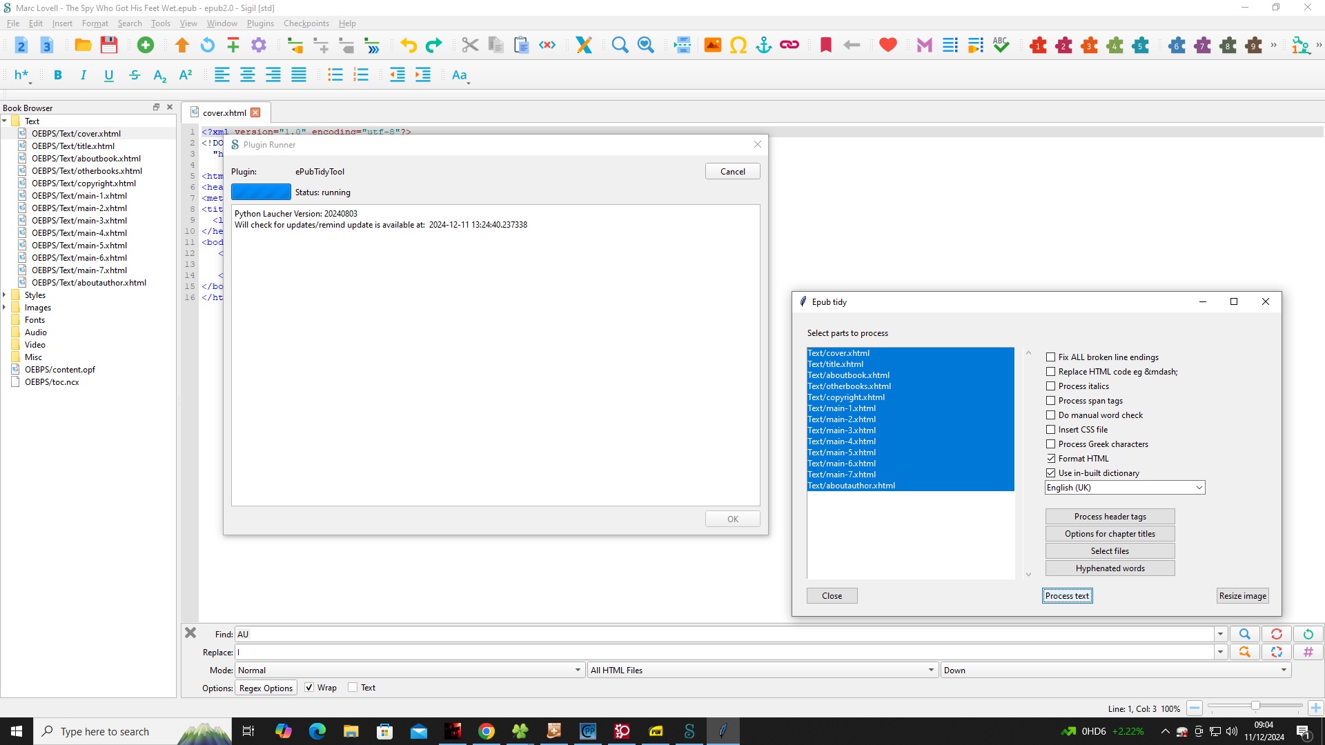

This is a screenshot of the plugin. I only know one way to launch the plugin, plugins, edit. I've selected all the files and pressed Process text and as you can see there is nothing happening.
httpsREMOVE://i.postimg.cc/d0Hyvzf2/screenshot.jpg
Is that any better?

OK. So the plugin is actually running. Its GUI dialog opens and allows you to make selections. It's after you try to process your requests that nothing seems to happen. Unless the epub (or its html files) are huge and you're simply not waiting long enough, my guest guess is that there's something about the epub(s) that's causing the plugin to hang. Have you made sure there's not a Pop up that's hiding underneath the other Windows? Nothing has changed with Sigil or this plugin since you last reported success on 25 November 2024. Unless you're running some sort of beta build of Sigil?

Okay, I am now working with a copy of the problem epub. This epub passes epubcheck. In all ways it just looks normal.
I then made a Checkpoint of the epub in order to look for any changes.
I then fired up ePubTidy and the plugin gui started up just fine.
I used the same setting as in the picture posted above and ran it and got nothing to indicate that anything was done.
I then checked the procecess span tags, and hit Process Text again and a list of 3 span tags immediately appeared.
So the plugin is running and at least properly handling span tags.
I will now try to add some debug print output to epubtidy to see what is going on.

It all appears to be running just fine.
There is a call to HTMLProcessor code but it is hard coded.
This is with the latest version of ePubTidyTool.
Update: there is code to check the "FormatHTML" preference check in HTMLProcessor
It does look for the FormatHTML prefs setting and if it changes anything, it prints to the screen that changes were made.
So my guess is there are no changes that need to be made for the FormatHTML checkbox and so no output is generated.
That said, debug output in the processHTML routine in HTMLProcessor.py shows it is hanging for some reason.
So we are back to something in the files causing a hang. But I can not tell what.
