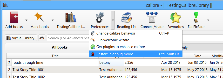

I don't have any problems downloading that story.
You can run in debug mode from the Calibre Preferences drop down. See attached.

FFF:DEBUG:calibre_plugins.fanficfare_plugin.fff_plugin(828):FanFicFare v2.2.6
FFF:DEBUG:calibre_plugins.fanficfare_plugin.fff_plugin(864):url:http://voracity2.e-fic.com/viewstory.php?sid=90
FFF:DEBUG:calibre_plugins.fanficfare_plugin.fanficfare.adapters.base_adapter(294):#####################################
pagecache MISS: http://voracity2.e-fic.com/viewstory.php?sid=90&index=1
pagecache MISS: http://voracity2.e-fic.com/viewstory.php?sid=90&index=1&ageconsent=ok&warning=4
FFF:ERROR:calibre_plugins.fanficfare_plugin.dialogs(653):Exception: {u'author': [u'Unknown'], u'end': None, u'comments': u'', u'listorder': 0, u'site': 'voracity2.e-fic.com', u'pubdate': None, u'begin': None, u'title': u'Unknown', u'calibre_id': None, u'good': False, u'comment': u'sequence item 0: expected string, list found', u'added': False, u'all_metadata': {'series': '', 'formatname': '', 'readings': u'276', 'rating': u'FRT', 'authorHTML': u"<a class='authorlink' href='http://voracity2.e-fic.com/viewuser.php?uid=615'>Voracity2</a>", 'siteabbrev': u'voe', 'dateCreated': u'2015-06-04 10:12:12', 'seriesUrl': '', 'language': '', 'formatext': '', 'site': u'voracity2.e-fic.com', 'category': u'Buffy Stories & Crossovers, Avengers, Other Movie', 'ships': u'', 'storyUrl': u'http://voracity2.e-fic.com/viewstory.php?sid=90', 'cover_image': '', 'authorId': u"[u'615']", 'status': u'Completed', 'authorUrl': u'http://voracity2.e-fic.com/viewuser.php?uid=615', 'numWords': u'136,863', 'langcode': '', 'description': u"Xander Harris and Darcy Lewis have insane lives.  Adding in some...higher beings with ideas about their bloodlines isn't going to make it any less insane.", 'warnings': u'', 'characters': u'', 'storyId': u'90', 'output_css': '', 'extratags': u'FanFiction', 'dateUpdated': u'2015-06-03', 'numChapters': u'8', 'seriesHTML': '', 'author': u'Voracity2', 'datePublished': u'2015-06-03', 'reviews': u'0', 'lastupdate': u'Last Update Year/Month: 2015/06, Last Update: 2015/06/03', 'genre': u'', 'version': u'FanFicFare v2.2.6', 'title': u'Weird Old Lines.'}, u'url': 'http://voracity2.e-fic.com/viewstory.php?sid=90', u'author_sort': [u'Unknown']}:sequence item 0: expected string, list found
  File "calibre_plugins.fanficfare_plugin.dialogs", line 643, in do_loop
  File "calibre_plugins.fanficfare_plugin.fff_plugin", line 1026, in prep_download_loop
  File "calibre_plugins.fanficfare_plugin.fanficfare.story", line 566, in dump_html_metadata
TypeError: sequence item 0: expected string, list found
The latest posted test version already fixes that problem.
