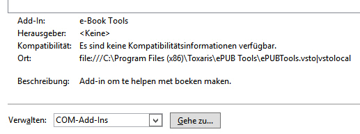

Same story here - after upgrade of my Office 365 Epub-Tools ceased to work and does not appear in the ribbons.
I looked into <Options/Add-ins>: Epub-Tools is registered but in a funny fashion (see attached screen shot).
Any help appreciated!
Klaus
If I am not mistaken, the current Word version in Office 365 is Word 2015, right? It might be that something has changed in that version with regards to add-ins/VSTO. I will try to check that out. I do not have version 2015, so I am unable to check.
Is the add-in enabled? Have you checked that .Net Framework 4 is installed?
The screenshot looks normal to me though.
