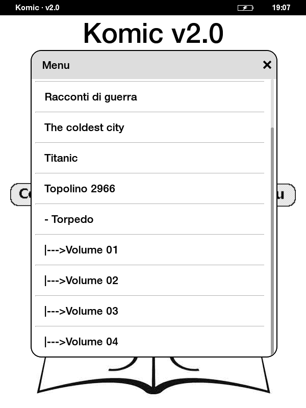

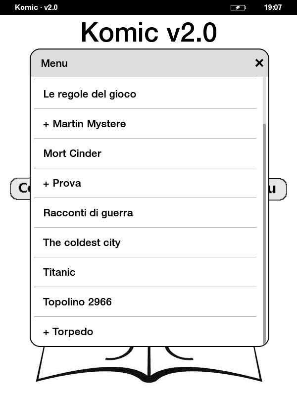

BTW, here is the final version of the dropdown menu...
The drawback is still there, but it looks cool (IMHO!!).
Anyway, next release will have also the cover view, so you can choose which to use!
In the meanwhile I'm studying how to create a custom menu using Kindle's own system!
Screenshots explanation:
- first screenshot is taken immediatly after Komic has loaded
- second screenshot is taken after having tapped on Torpedo
ID:	94831   Click image for larger version

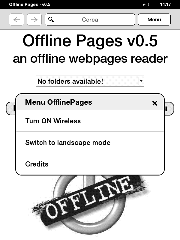

Small update....
I'm *mastering* menus!
I managed to create a new menu for my "testing application": it is used to toggle wireless connection and orientation.
This can be directly ported to Komic to replace the menu page!
As regards the dropdown menu, I still need to understand how to create a two-level menu (probably GUI launcher is the place where to look).
Otherwise, I'm thinking about using a page similar to the bookmark page of the stock browser!
silver18 is offline   Reply With Quote

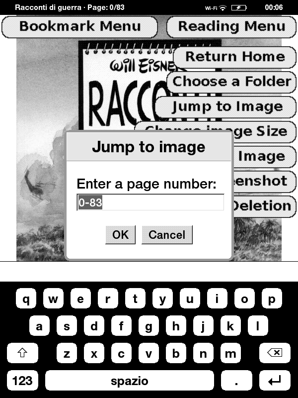

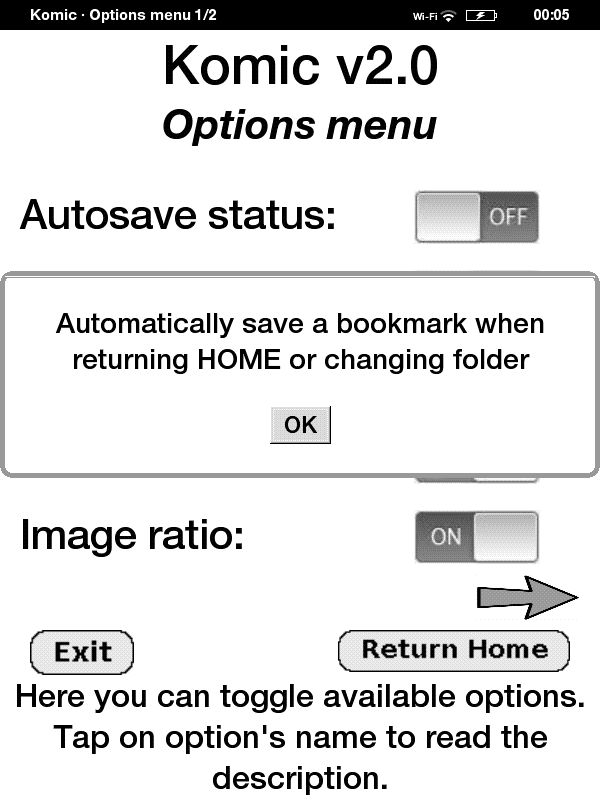

Work's going on...
I changed all JS's alerts with jquery's dialogs.
Same for prompts and confirms.
We can now get rid of the welcome popup!!!
BUT I'm experiencing a strange behaviour with prompts. They worked fine both in landscape mode and in portrait mode.
Then, suddenly, they stopped working in portrait mode (komic crashes when I enter the second character in the prompt box!!!) but they still work in landscape mode.
Landscape and portrait share the same JS, same jquery and similar CSS (unless page dimensions!!)
I'm a bit confused!!!

EDIT: Everything seems to work now....it was *probably* related to draggable divs...
Anyway, here are screenshots!!
PS If I manage to solve this problem, I can go on and try the last thing: change the dropdown menu with a nice new page!
