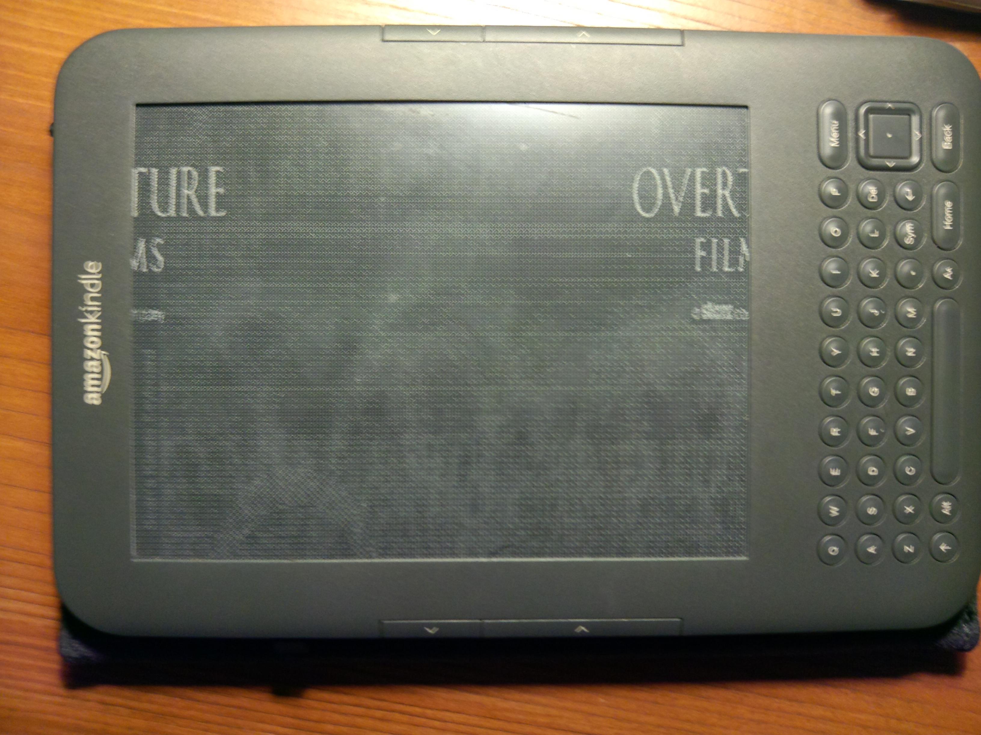

Video rolls?
Hi. I ran gmplay with some of the included videos and it worked perfectly.
However, when I tried to convert my own, the picture does a strange rolling thing. I tried using different video formats, different resolutions, different kindles (kindle 3 and 5 main), and two different computers. Always the picture rolls, whether it's from a file or nc.
Sorry, I know this is operator error, but I'm not sure what I'm doing wrong.

You may have the image larger than 800x600. The raw2gmv program assumes that it is raw 800x600 grayscale 8bpp input video with no headers or metadata. It gets rotated to 600x800 during conversion.

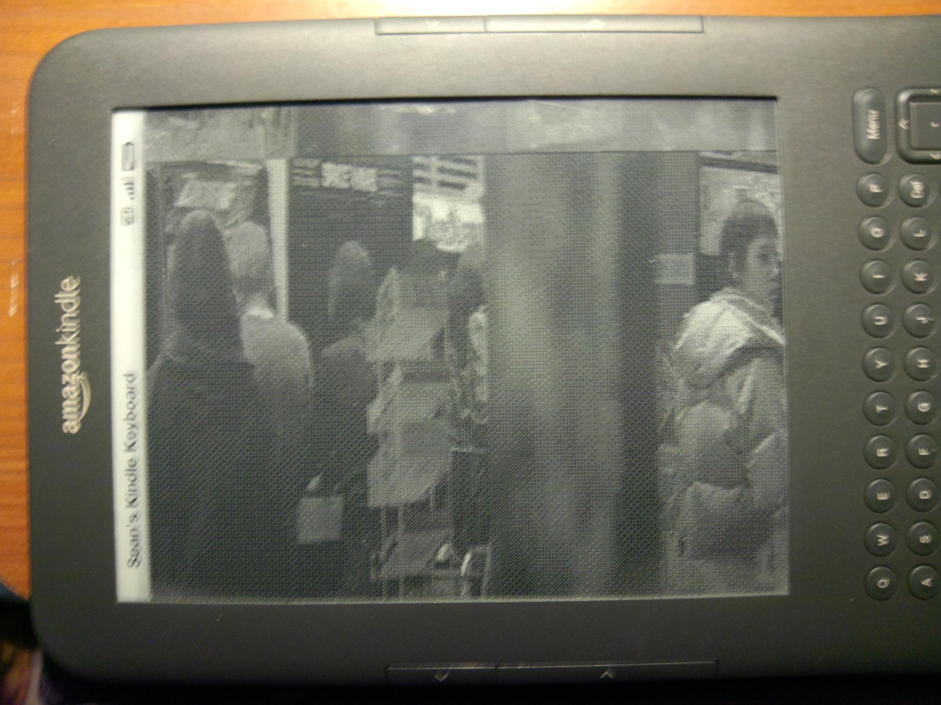

Thanks for the fast response, but no - the command I'm using is basically the one you specified for playing a local file:
ffmpeg -i lmi.avi -pix_fmt gray -f rawvideo -s 800x600 -|/root/raw2gmv|nc -l 5555
I attached a few pictures of what I mean. One is from the middle of the movie, and shows the bottom-to-top rolling. One is from the beginning, and shows the left-to-right rolling. Oddly they do both at once - I would expect one or the other but...

Okay - I piped ffmpeg to sample.raw then played it with raw2gmv and nc to my kindle - I got a slightly faster frame rate, but still rolling.
When I use gcc to compile raw2gmv it seems a little better - when it works. sample.raw played rolling with raw2gmvtcc but didn't display at all with raw2gmvgcc. nc worked better with gcc, I think it only rolled side to side.
EDIT: Actually no, raw2gmvgcc works just the same as raw2gmvtcc. I attached sample.gmv.gz, it was made with raw2gmvgcc and behaves the same as earlier gmv.gz files I've made with raw2gmvtcc.
