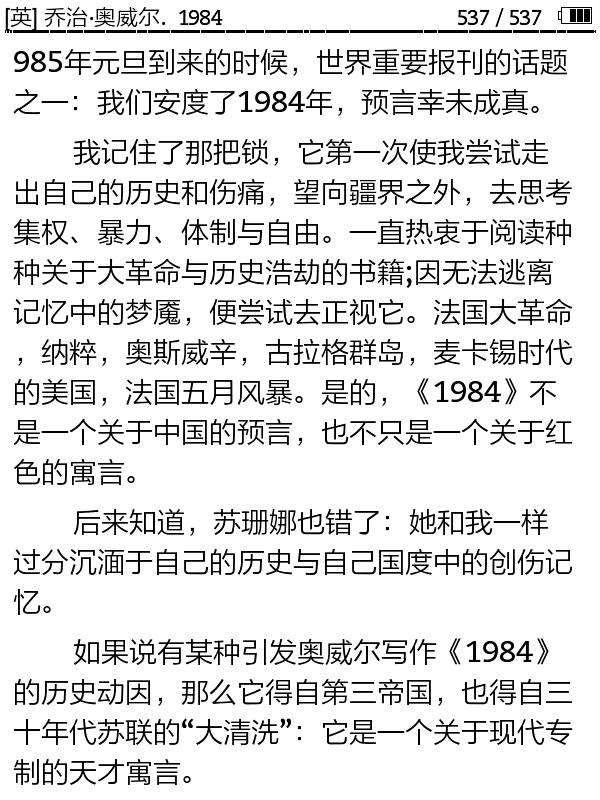

I've looked into this and it appears that's because the Coolreader engine just considers Chinese text as one long word. The same would happen if you used Latin characters without any space in it.
I'll try some time if I can add a proper line breaking to these kind of texts.
The only thing I can think of is that there's a font that lets the program crash with Amazon's own freetype library. Although this would be the first report about a font that let it crash when trying to render text with it.
i'll be most grateful if you can solve the punctuation problem
as in English or other languages, there are certain rules concerning layout. Here are the ones for Chinese text for your reference:
punctuations that should not start a line:
!),.:;?]}¨·ˇˉ―‖’”…∶、。〃々〉》」』】〕〗!"'),.:;?]`|}~¢
punctuations that should not end a line:
as for crashing of the program, i think i know the reason. i've copied the improved Caecilia font from Amazon to /mnt/us/fonts and has left the original Caecilia font untouched. i did a ;fc-cache and have no problem using the improved font, but i suppose it caused the hackedupreader to crash when i tried to change the font settings.
Edit: i confirm that the crash was caused by the Caecilia font in /mnt/us/fonts. once i removed it, everything became normal.

Originally Posted by yiming View Post
i'm using bhaak's Hacked Up Reader version 0.2.1, and varnie's HackedUpReader Launcher. i didn't install the freetype library.
i find the font rendering satisfactory, here's a screen capture, the font used is xHei:
Attachment 96540
as i've mentioned, the only thing i'm not happy with is the punctuation marks appearing at the first column.
btw, let me correct what i've said in that last posting. for text file, you need not set "Preformatted text" to Off. and for epub, you don't have to set "Document embedded styles" to off. it seems that the most important setting is "Fallback font face". as long as you set it to a Chinese font, you should have no problem reading epub, text or mobi books.
Lately, however, i've problem changing the "Fallback font face". i'm stuck at page 2 of the selection and can't go to page 1 to select other fonts. whenever i tried to go to page 1, the programme will close. not sure if it's because of incompatible issue with other apps i've installed.
The HackedUpReader works well after I installed four Chinese fonts to the system. Just select the Chinese font from the menu and it will display correctly. But it seems to be unable to show Chinese book title of txt files. Just ????.txt. Maybe I need to change some of the settings you mention above. But reading Chinese epub now is a enjoyment. I don't have to envy Nook users for their epub support anymore. Thank you very much.

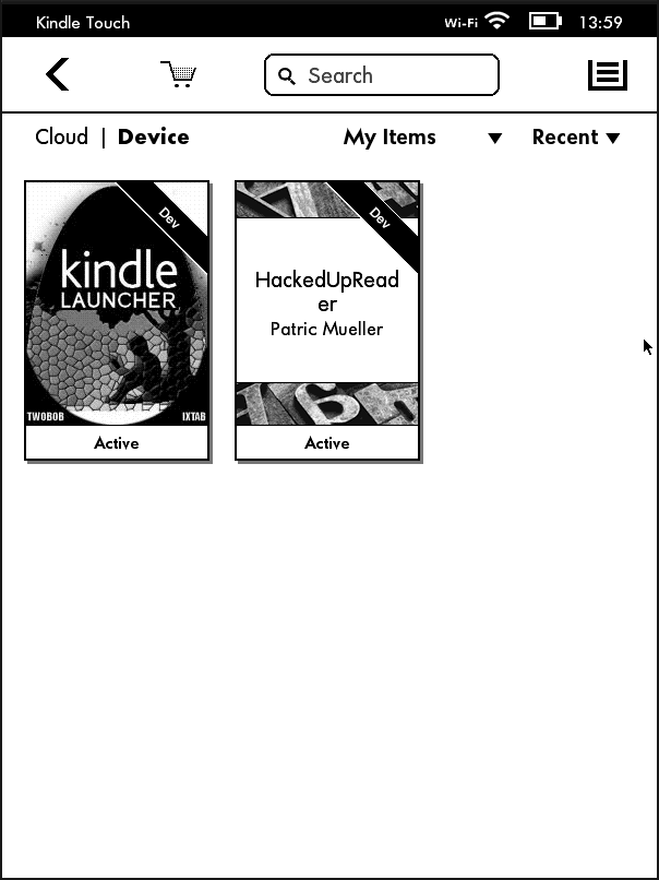

I found a way to start HackedUpReader from the home screen. This is currently experimental but especially for PW users I think this is better than nothing.
You have to install and execute the files manually but in a future release this will happen automatically.
Download the two attached files onto your K5 device and rename them to "policy.sh" and "HackedUpReaderKindlet.azw2". Put the HackedUpReaderKindlet.azw2 into your /mnt/us/documents/ directory.
Execute the policy.sh script (sh policy.sh) and restart your device or restart the framework.
You should see now a document named "HackedUpReader" on the home screen with a "Dev" marker. Opening it will start HackedUpReader.
There are some drawbacks:
1. when the devices suspends, HackedUpReader gets stopped too and will be restarted when the device is woken up again
2. HackedUpReader doesn't save the current reading position when it gets closed because of a suspend or press of the home button (I already have a fix for that but this will need a new release of HackedUpReader)

Lightbulb New release 0.4.0!
New release 0.4.0!
This is a maintenance release, without functional improvements, mostly for improved compatibility with the new Kindle firmwares and the Unified Applications Launcher.
Changes:
  • New stand alone launcher by Kindlet document
  • Varnie's HackedUpReaderLauncher extension bundled
  • Prevent multiple instances running concurrently
Varnie's launcher extension and the new Kindlet launcher are only in the zip file which contains the standard Kindle update package.
http://bhaak.net/kindle/hackedupreader_0.4.0.zip
http://bhaak.net/kindle/hackedupreader-0.4.0.tar.gz

Works great. I think I would possibly do a split in the name just to keep it tidy for the kindlet. (or a picture version perhaps)
Nice work. Haven't got it to "hang" yet.
Will update readme. thanks for your work.
Name:	TightVNC: kindle:0.0_064.png
