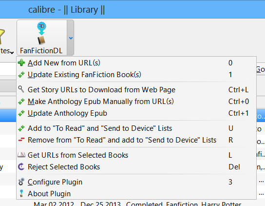

That's one solution, but it seems cumbersome to me. Look in 'updated' book, remember titles, search or scroll for them, get distracted, forget what the title was, etc.
I generally have anywhere between 10 and 30 items on my 'To Read' list. My solution is to use the Reading List plugin and FFDL's features for updating and managing a 'To Read' list with a custom column and a metadata plugboard. Then all the new or updated books have 000 at the front of the title and appear at the top of the list.
This details it:
http://code.google.com/p/fanficdownl...ithReadingList
That, plus some hot keys(see image), means that I go back to my calibre when I've finished reading a few updates, select them, and hit 'r' for 'read'. Then next time I sync, those books are updated without 000 at the front.
Other options include putting an updated custom date column in the title with a plugboard, or creating a catalog with such a column.
