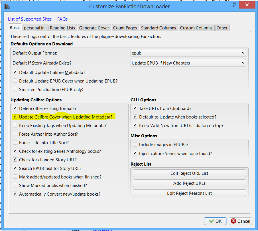

When I tried to check for new chapters to a previously downloaded story, A Travesty, the story file updated, but the number of chapters in the calibre preview pane says 5, and the story now has 11 chapters.
Is that a Calibre error, not updating the preview of the EPUB 1st page?
Does the title page inside the epub should show the correct chapter count? If it's only the cover image in calibre that's out of date, make sure that you have the option in FFDL config for updating the cover turned on. See attached image.

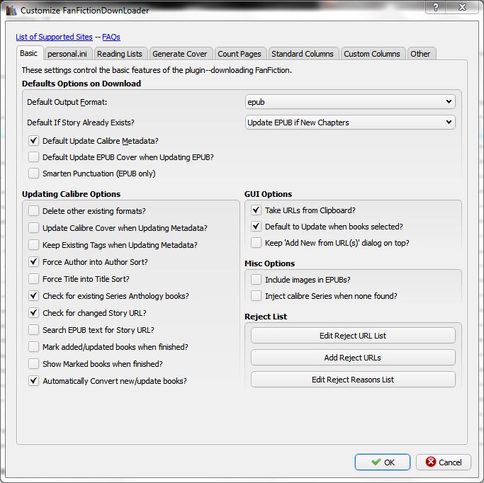

auto-convert feature
So I finally got around to updating FFDL (I was a couple versions behind >_<) and found this wonderful little addition "Automatically convert new/update books?" Yay!
My only problem now is that it only works on newly added books. Am I mistaken that it should also convert updated books? My basic page is below, should I change something to make it work better?
Name:	FFDL basic.JPG
Updates should also kick off the convert. They do for me...
