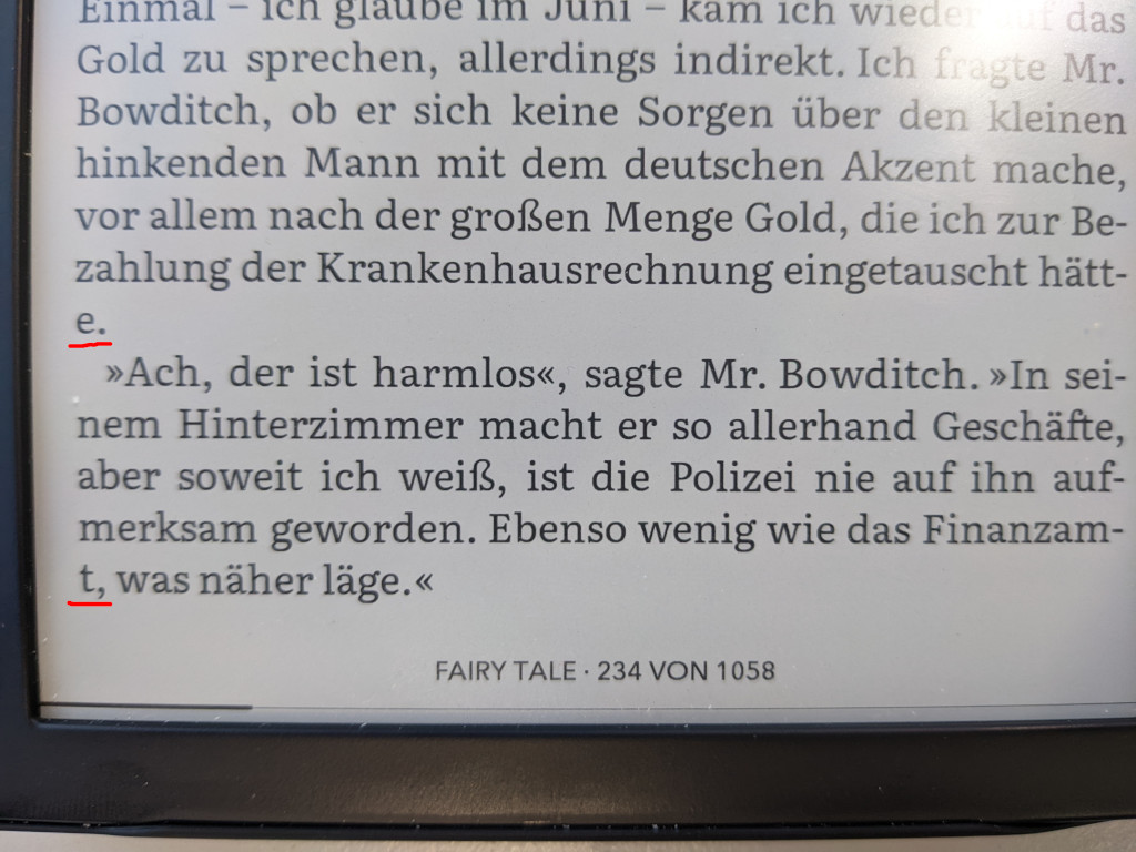

Just for the record, with the improved hyphenation from this thread I also (quite often) get single letters on one side of the hyphenation (German in my case).
beedaddy is offline   Reply With Quote
Old 09-21-2022, 09:27 AM   #240
Posts: 81,908
Karma: 150266009
Please give this new version a test. Thanks.
