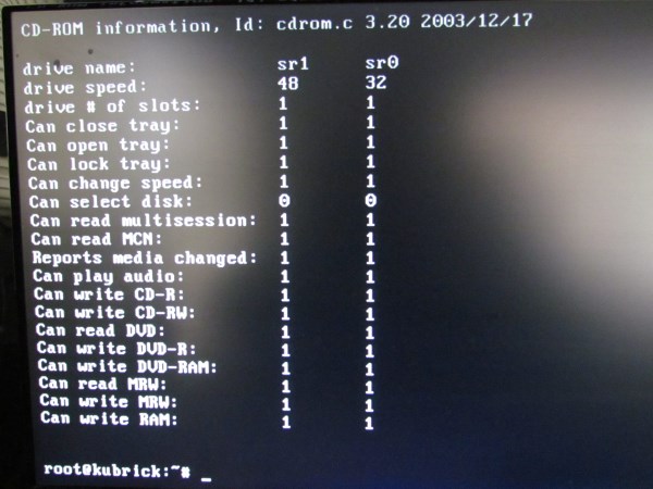

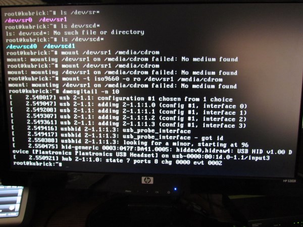

Recountryman: do you mind trying again, but instead of shutting down, issuing the following commands:
ls /dev/sr*
ls /dev/scd*
mount /dev/sr1 /media/cdrom
mount -t iso9660 -o ro /dev/sr1 /media/cdrom
dmesg|tail -n 10
Please post the exact output (or pictures of the screen)... Thanks!
And oh, of course "cat /proc/sys/dev/cdrom/info" would be helpful too

ok here they are...
Name:	IMG_0536 (600 x 450).jpg
ID:	103420   Click image for larger version
Name:	IMG_0539 (600 x 450).jpg
Recountryman is offline   Reply With Quote

Originally Posted by Recountryman View Post
ok here they are...
Thanks a lot!
Now... that second picture pretty much explains everything - my logic for enumerating the devices doesn't work when there are multiple devices...
Will be working on version 3.2 then.
