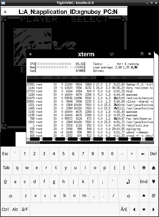

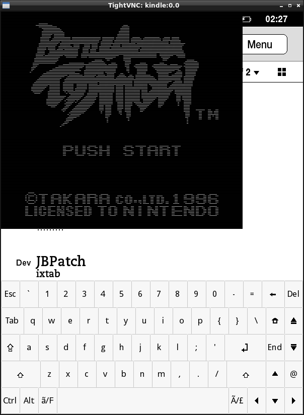

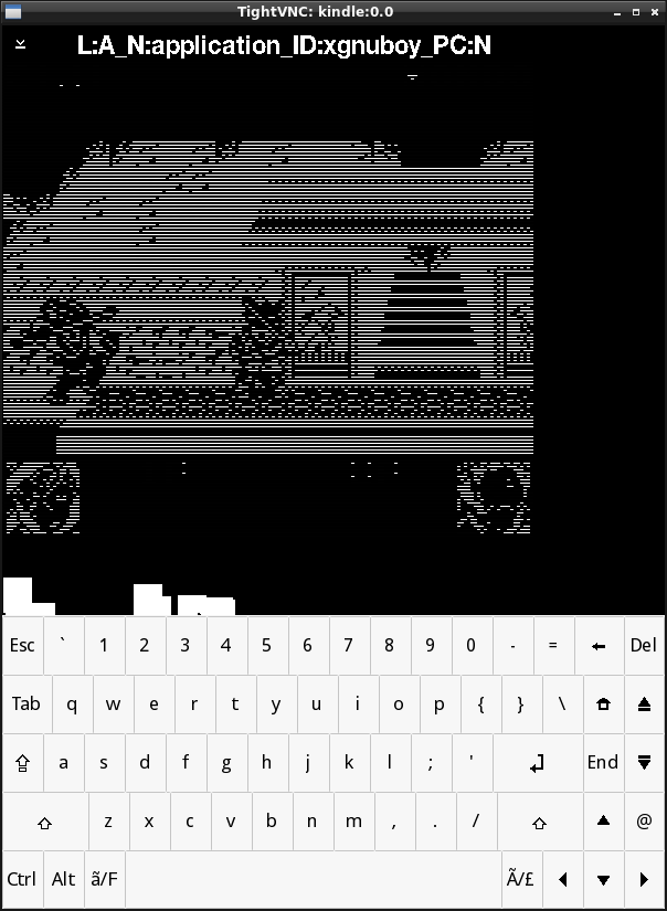

I am was working on getting the 3 version to not suck when emulating X.
a pointless task as the FB version is fine. but it got my head into the code
When we have a version of x for the 3 that can manage native e-ink updates it will work better. The above screenshot suffers from lag as I am running it via an vnc yoke.
Let me have a look at getting this solid on the 5 then i will go back.
Sound is indeed on the list. having a think about that next
actually the dithering does work better on side scrolling adventures for some reason via the vnc. I should figure out why.
there is an issue where long pressed keys are unpressed.
this needs fixing for driving games etc. doable no doubt.
Touchscreen support has also been added to the FB version of the fbgnuboy build on the touch. to give us options going forward. But I will be focusing on the X version on the touch from now on for a while I think.

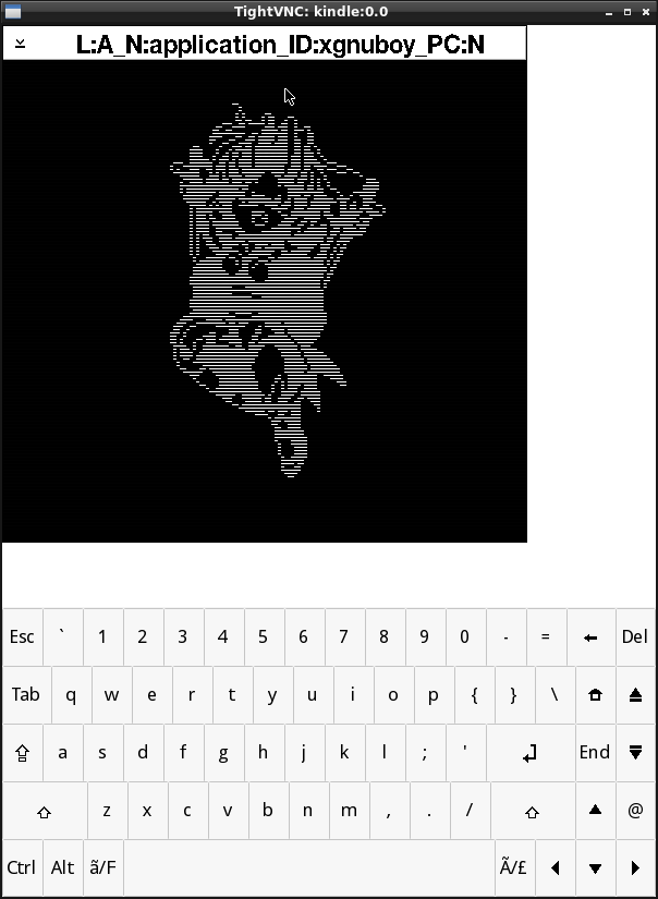

Xgnuboy builds okay now:
which means we can start to use some of the flags from
http://gnuboy.googlecode.com/svn/trunk/docs/CONFIG
humph. well, Failed again to get my head around the dithering code. How one might port the current fb info based dithering into the X implementation is out of my brain price range today.
I could post the code that builds for the xgnuboy.
see if someone else wants to sort out the dithering.
Not much point posting the binary till it's gets sorted.
I may handle the dither in Xephyr though...
However at least the xgnuboy makefiles includes and alsa implementations are in place.

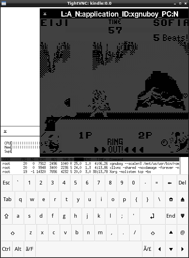

Some sound support:
on the plus side I added sound support the xgnuboy that seems to work great work most of the time on the Touch heh. shocking sound support on these kindles.
Yay me. perhaps a prod with aplay at startup will make it a bit more solid. or a double init. or more error handling ;P
EDIT:
however not so for the 3.
since cvm seems to want to be active for playback on the 3 and that is currently nerfed this is a problem. plus just to be extra awkward for some reason the sound does nothing despite initialising fine.
I think sound will be a touch only feature. I will rip it out of the 3 build. I will also restore the original kindle input configuration for the 3 since the touch version will use the xinputs.
I am deciding if I should wrap it in a Xephyr as the -title or even direct injected Xnaming is not playing ball : )

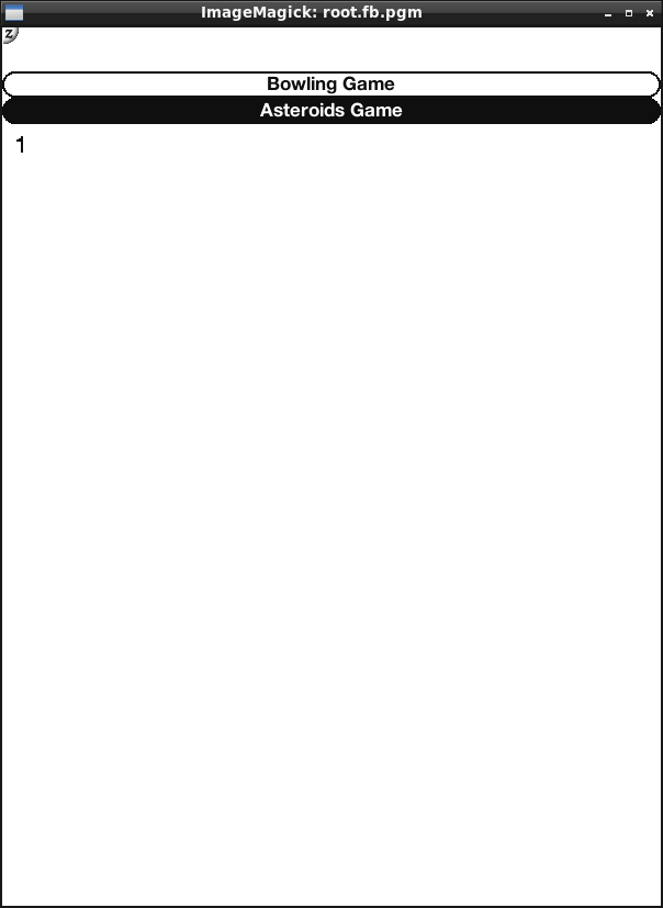

"Could someone wrap this in a Kindlet that appears on the home screen and displays a rom file browser?" is closer to fruition however. As the OLD code from the SoundKloud project (The unreleased kindlet version) can actually probably be re-purposed "AS IS" (with a few tweaks) to do that job. May do that. Or maybe in gtk.
Had a play doing this via a kindlet... However pausing cvm via the kindlet and safely returning via a callback (or something) is hurting my head.
Will think about another solution.
