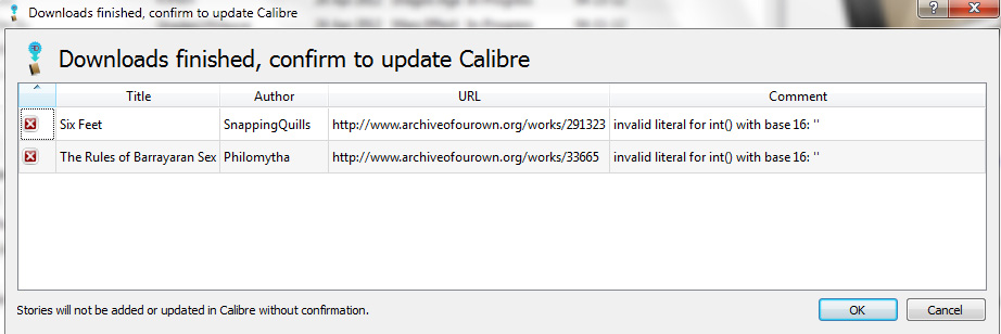

Hey, some more AO3 wackiness. I'm using the latest version of both calibre and the plugin. The other AO3 stories I have work just fine. Just these 2 black sheep.
I've enclosed a screenshot with the error message and links that are acting up.

v1.5.16 posted with change:
Fix for Yet Another numeric entity issue for pookakitten's problem.
