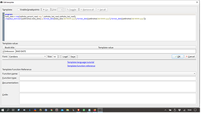

program:
kobo_date = cmp($$#kobo_percent_read, 100, '', $$#kobo_last_read, $$#kobo_last_read);
cmp(days_between($$#finished, kobo_date), 0, format_date(kobo_date,'dd MMM yyyy'), format_date($$#finished,'dd MMM yyyy'), format_date($$#finished,'dd MMM yyyy'));
That would use the latest of either of the two dates and only use the Kobo timestamp if the book is finished.
My apologies for the confusion. I only wish to have one "Finished" column that displays the date when the book is finished (100%).
I tried replacing the code with what you provided in your first reply and it deleted all the previously existing dates (a result of a convoluted method I was using). Then I tried the code above and it placed an entry in every book in my library with BAD DATE. I stumbled upon the template editor and a few things were highlighted in blue, if that means anything. (see screenshot).
To keep it simple, all I am trying to create is one column, with a single entry of dd MMM yyyy when a book is finished and I connect a device to Calibre.
The first three fields are:
Lookup name: finished
Column heading: Finished
Column type: Column built from other columns
Thank you for your assistance. So close, but not quite there.
Thank you for your assistance. I have no idea how to fix this.
That means you want the first template. You will have two date columns. One is the last read timestamp which is updated from the device. Or you can set manually. The other uses the first template and will show the date from the last read column when the percent read is 100. Use the template editor and replace the template you have with the first one. If you only want to see the one column in the list, then you can hide it. Right-click on the column header and select the option to hide it.
The error you have above is because the template is referring to the column it is in. The lookup name is "finished" and you use that in the template. You need to refer to a different column. Which would be the column you deleted.
davidfor is offline
I've made several attempts to no avail. I created one date column but don't quite know what I need for the second column. I'm completely confused by "refering to the column I deleted." How is that possible?
Lookup name: kobolastread
Column heading: Last Read
Column type: Date
The second column must be created as both the current and previously deleted "Finished" column types are "Column built from other columns" and cannot be edited. What is required below to work with the first template?
Lookup name: ?????
Column type: Date ??????
Boy, oh boy, I should have left well enough alone.
Skydog is offline
Column type: Date
That is the column to store the last time read when it is fetched from the device.
Lookup name: ?????
The second column has the column type "Column built from other columns". The lookup name and column heading are whatever you want. So, the heading is probably "Finished", and you can use "finished" for the lookup name. You set the template to what I first posted. And you set the "Sort/search column by" to "Date". With that, the column will show either nothing (the percent read is less than 100) or the date retrieved from the device when the book was finished (the percent read is 100).
davidfor is offline
Thank you, davidfor. Unfortunately, no success. The "Finished" column remains blank, only the the "Last Read" column contains entries:
Column type: Date
Template:
program:
cmp($$#kobo_percent_read, 100, '', format_date($$#kobo_last_read,'dd MMM yyyy'), format_date($$#kobo_last_read,'dd MMM yyyy'));
Skydog is offline
Column type: Date
Template:
program:
Skydog is offline
Any ideas, anyone?
Have you changed the name of the column in the template? The template I posted used my column names or ones I guessed from your posts. The lookup name for your last read doesn't match what you have in the template.
davidfor is offline
Old 11-26-2021, 12:55 AM   #2355
Skydog
Skydog's Avatar
Posts: 2,286
Karma: 7409537
Nothing has changed with the information in my post#2348. I'm sorry, but I do not understand if I should edit the template or the lookup and with what? Would you be so kind to provide the required correction? That would be most helpful for me to understand. I very much appreciate your help, not to mention your patience.
