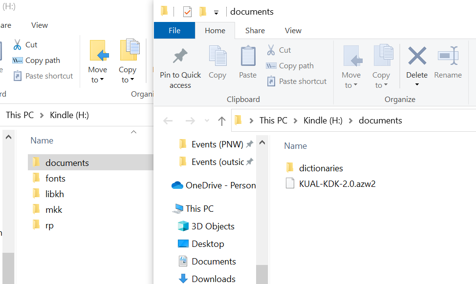

My Kindle Voyage is jailbroken. But I cannot get KUAL to appear in the book list.
I am looking at "Your Library" -> "Downloaded". The only icons are "Kindle Feedback" and "set Up Your Kindle." The firmware version is 5.13.6.
What am I missing?
If it matters, I'm trying to get the Downgrader tool installed to go back to factory firmware. KUAL is a prerequisite for that.
What am I missing?
The KUAL installation instructions are long and complicated because of the wide range of hardware, time, and firmware versions. You need to read and follow them carefully.
You have tried to install the kindlet version, which has not worked for years (since fw 5.9.x).
Find the instructions for the coplate version and istall the latest version of that (but first carefully read the first post in the KUAL thread).
After you downgrade to a version lower than 5.9 you can install the kindlet version if you really want to. (I know of no reason not to stick with the latest KUAL, but it is your choice.)
When you install new firmware, whether higher or lower than your current version, you have to reinstall all mobileread packages, including KUAL.

Thank you! That solved the problem. After a downgrade to 5.8.2, I was able to follow up with a downgrade to 5.5.0. My Kindle Voyage UI hasn't looked this good in years.

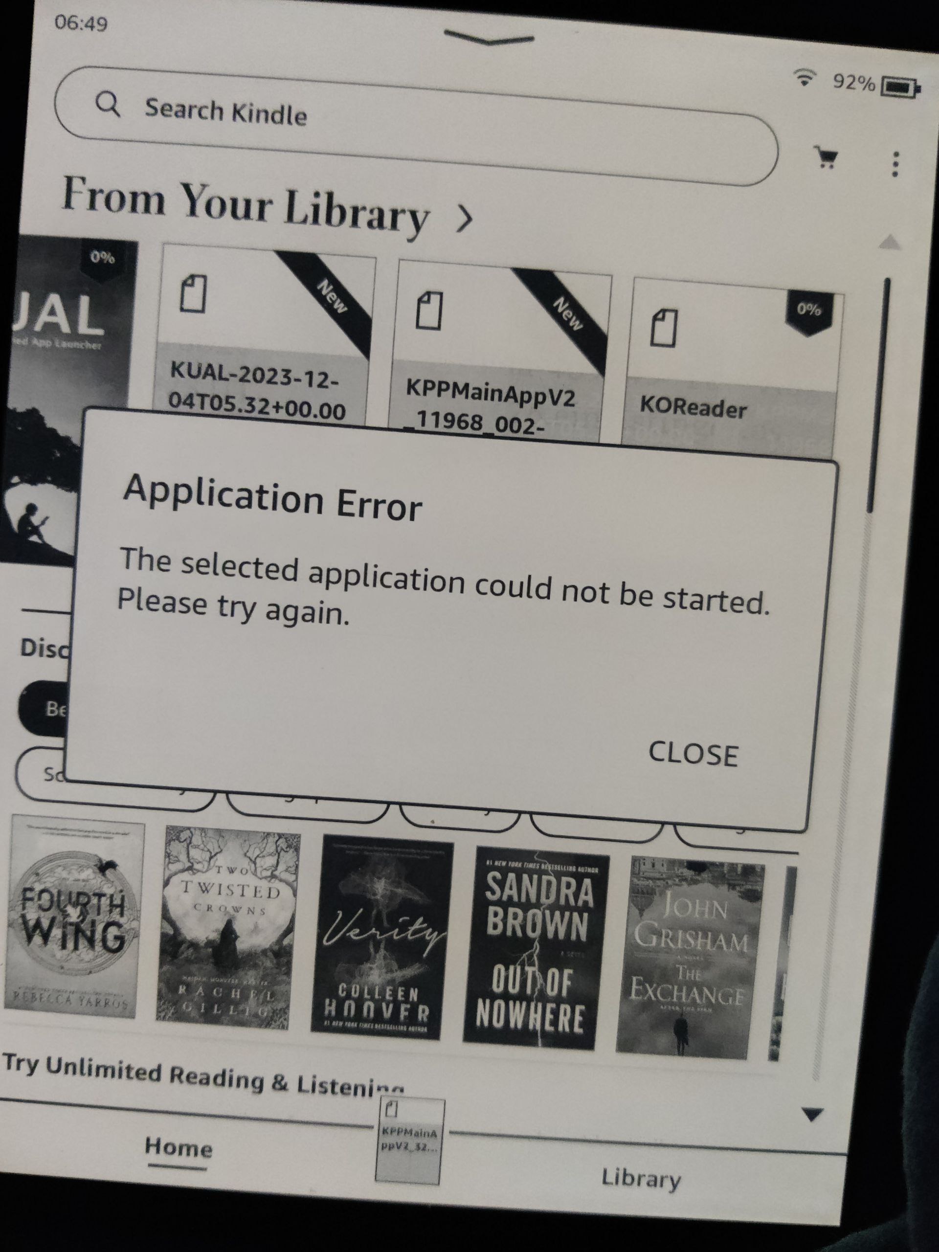

I tried to uninstall KOL, but in the main menu and library, the KOReader "book" still remains. In the appreg.db file (when editing via text editor) data related to KOLauncher still persists:
ºedccRAMP.features.default.status.AUTO_SHELFÊ3a
dccRAMP.features.default.status.BETA_FEATURESQ/
dccgdpr.toggle.value*F
dccRAMP.features.default.status.BETA_FEATURESí9K5
com.mobileread.ixtab.kolaunchersupportedOrientationxÀf
com.mobileread.ixtab.kolaunchersearchbar-modewÀ2
com.mobileread.ixtab.kolauncherextend-startv1K%
com.mobileread.ixtab.kolauncherunloadPolicyu@
com.mobileread.ixtab.kolauncherdefault-chrome-stylet1K%
com.mobileread.ixtab.kolaunchermaxPauseTimesŽ/
com.mobileread.ixtab.kolaunchermaxGoTimer2K'
com.mobileread.ixtab.kolaunchermaxUnloadTimeqr
com.mobileread.ixtab.kolauncherjarp+K
com.mobileread.ixtab.kolauncherlipcIdo
dccfl.default.automodec
When I display this file in DB Browser for SQLite, I can't find anything related to KOL.
MRPI LOG:
[2023-12-04 @ 06:28:34 +0100] :: [MRPI r19303] - Beginning the processing of package 'Update_KOLBooklet_V1.4.2_uninstall.bin' (KOLBooklet V1.4.2 U) . . .
Extracting update package 'Update_KOLBooklet_V1.4.2_uninstall.bin' to '/var/tmp/mrpi/staging'.

Running 'uninstall.sh' for 'KOLBooklet V1.4.2 U' (Update_KOLBooklet_V1.4.2_uninstall.bin) @ Mon, 04 Dec 2023 06:28:34 +0100
system: I ota_script:uninstall::uninstalling booklet
system: I ota_script:uninstall::deregistering booklet
system: I ota_script:uninstall::removing application
system: I ota_script:uninstall::cleaning up
system: I ota_script:uninstall::done
Success! :)
Rebooting does not solve this.
juliazero is offline   Reply With Quote
Old 12-04-2023, 08:08 AM   #2264
mergen3107
mergen3107 ought to be getting tired of karma fortunes by now.mergen3107 ought to be getting tired of karma fortunes by now.mergen3107 ought to be getting tired of karma fortunes by now.mergen3107 ought to be getting tired of karma fortunes by now.mergen3107 ought to be getting tired of karma fortunes by now.mergen3107 ought to be getting tired of karma fortunes by now.mergen3107 ought to be getting tired of karma fortunes by now.mergen3107 ought to be getting tired of karma fortunes by now.mergen3107 ought to be getting tired of karma fortunes by now.mergen3107 ought to be getting tired of karma fortunes by now.mergen3107 ought to be getting tired of karma fortunes by now.
mergen3107's Avatar
Posts: 1,722
Karma: 5004414
Location: Cape Canaveral
Device: Kindle Scribe
Reinstall KOL, then delete KOReader icon in Kindle Home menu (as if it was a book), then apply uninstall.bin again.
I had the same issue just recently. The problem stems from the icon setter extension.
mergen3107 is offline   Reply With Quote
Old 12-04-2023, 09:42 AM   #2265
juliazero
Trans girl (she/her)
juliazero is slicker than a case of WD-40juliazero is slicker than a case of WD-40juliazero is slicker than a case of WD-40juliazero is slicker than a case of WD-40juliazero is slicker than a case of WD-40juliazero is slicker than a case of WD-40juliazero is slicker than a case of WD-40juliazero is slicker than a case of WD-40juliazero is slicker than a case of WD-40juliazero is slicker than a case of WD-40juliazero is slicker than a case of WD-40
juliazero's Avatar
Posts: 81
Karma: 73450
Join Date: Nov 2023
Device: KOA3 5.18.2 JB
Interesting. I unset cover and then removed KOL via uninstaller and this happened.
Thanks for help!
