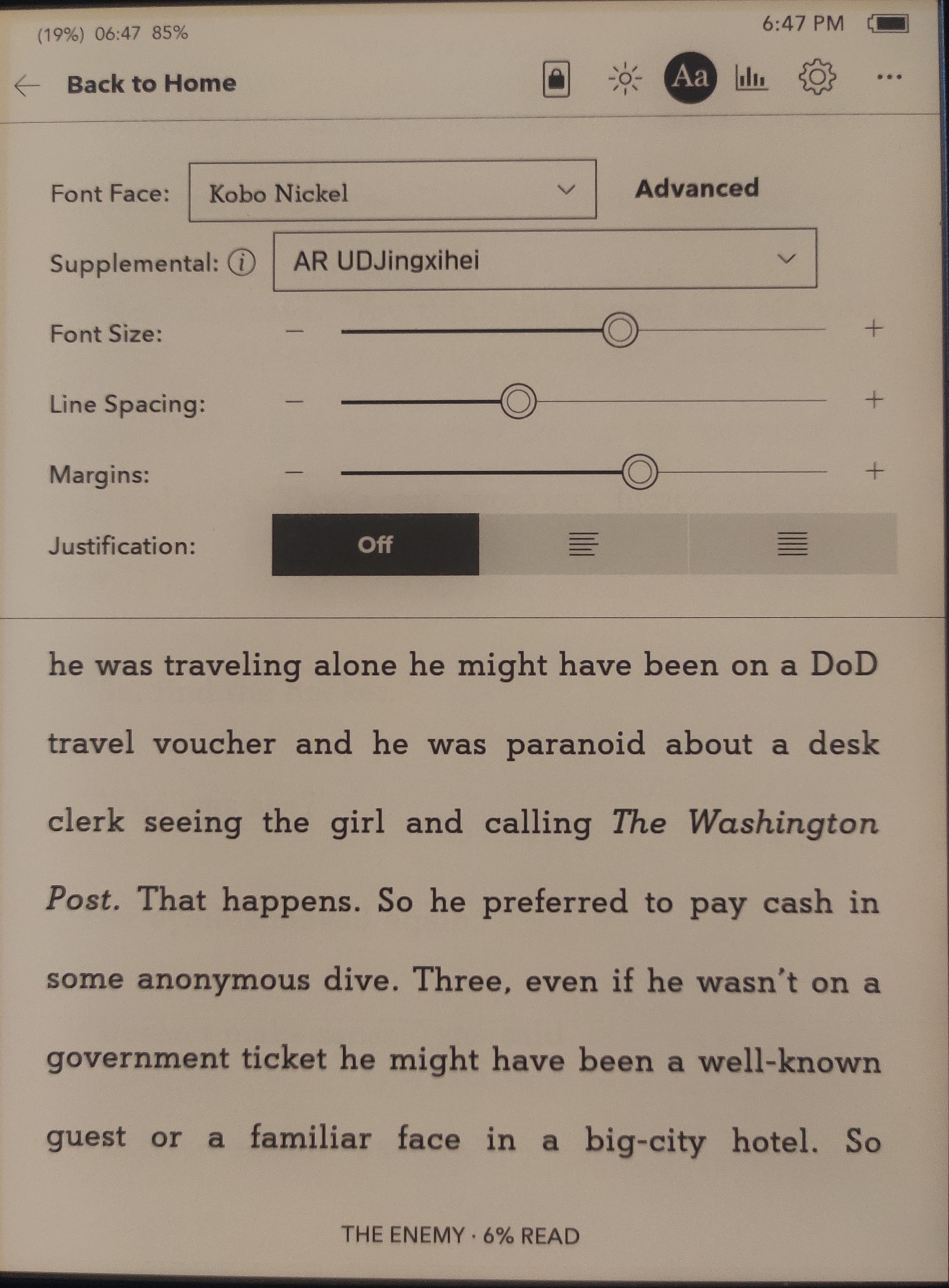

Is your kobo nickel font in 4.32 the same as before (older fw).
I noticed that the kobo nickel font has changed in 4.32. The old nickel font looks like times new roman/garamond type. now it is ugly.
Can you show us a photo of what Kobo Nickel now looks like?
Here it is

Odd.
In an epub the Kobo Nickel isn't like that! It's closer to Times Roman.
But I see that in kepub! It's almost like a proportional version of Courier, much plainer.
Kobo Sage with this FW. There is no secondary font option on epubs, only on kepubs, on the font Aa menu.
