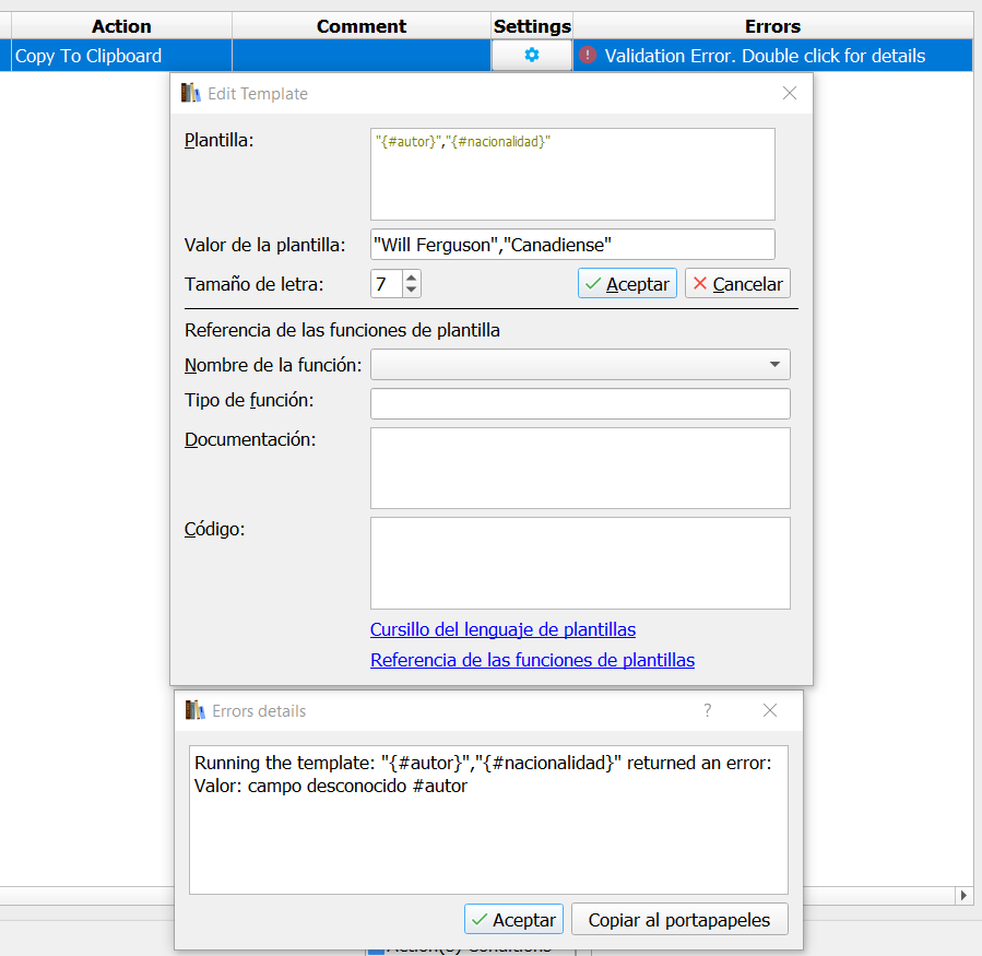

Old 12-30-2020, 11:12 AM   #225
jbacelar
Interested in the matter
jbacelar ought to be getting tired of karma fortunes by now.jbacelar ought to be getting tired of karma fortunes by now.jbacelar ought to be getting tired of karma fortunes by now.jbacelar ought to be getting tired of karma fortunes by now.jbacelar ought to be getting tired of karma fortunes by now.jbacelar ought to be getting tired of karma fortunes by now.jbacelar ought to be getting tired of karma fortunes by now.jbacelar ought to be getting tired of karma fortunes by now.jbacelar ought to be getting tired of karma fortunes by now.jbacelar ought to be getting tired of karma fortunes by now.jbacelar ought to be getting tired of karma fortunes by now.
jbacelar's Avatar
Posts: 421
Karma: 426094
Location: Spain, south coast
Device: Pocketbook InkPad 3
Issue with version 0.5.2
Until this version everything is fine. I think the screenshot explains it clearly.
jbacelar is offline   Reply With Quote
