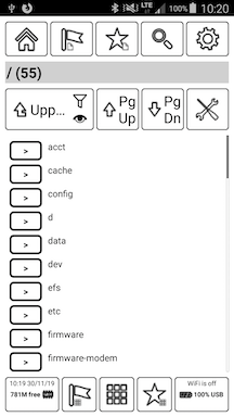

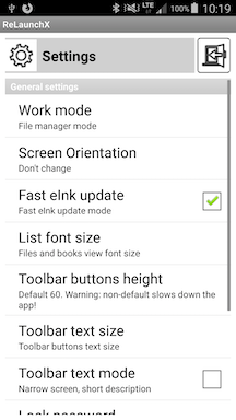

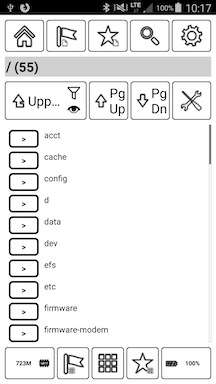

Pushed tag ReLaunchX_2.1.5, f-droid should build it soon
This is rather quick fix for narrow screens. You can choose the toolbar font size, and the level of text details on the bottom bar.
