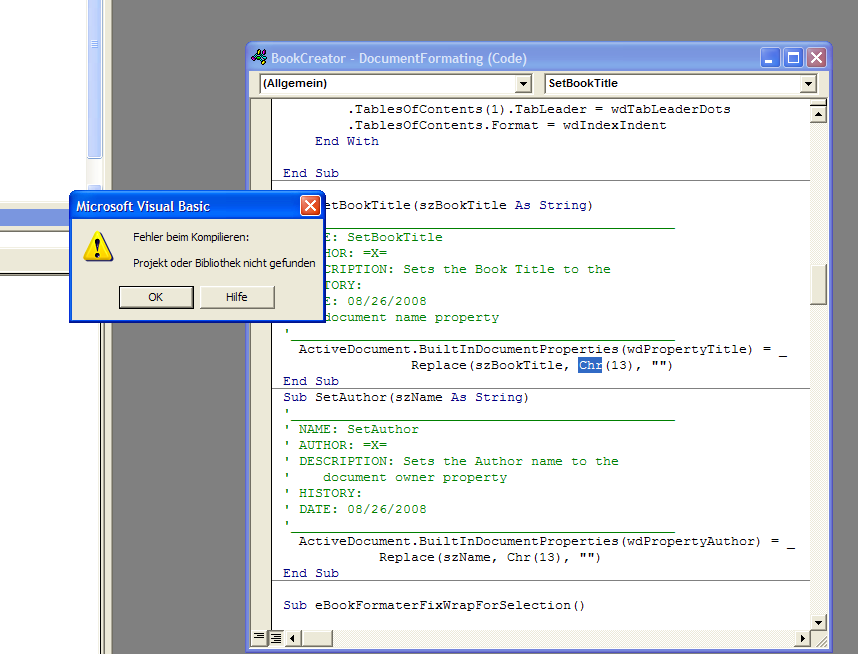

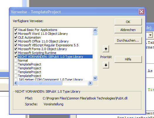

Hello,
I've tried your script. It's not working for me (XP - Word 2003).
The error message means : Project or document not found
On my machine I've found the vbscript.dll version 5.7.0.18066.
A library names PubX.dll is missing.
Nordlicht

@Nordlicht
Thank you for the detail, it makes troubleshooting much easier even if I don't read German.
Anyhow the problem you've listed is a known issue. See the larger banner on the first post (#1 link) for more details.
In short you must either revert back to version (2.5.2)
or
Download ePublisher (link)
@Student1
I suspect you are having the same problem as Nordlicht. Try either reverting back to 2.5.2 or downloading ePublisher.
=X=

Thank you very much, thats exactly what it needed! Installing ebook publisher did it !
