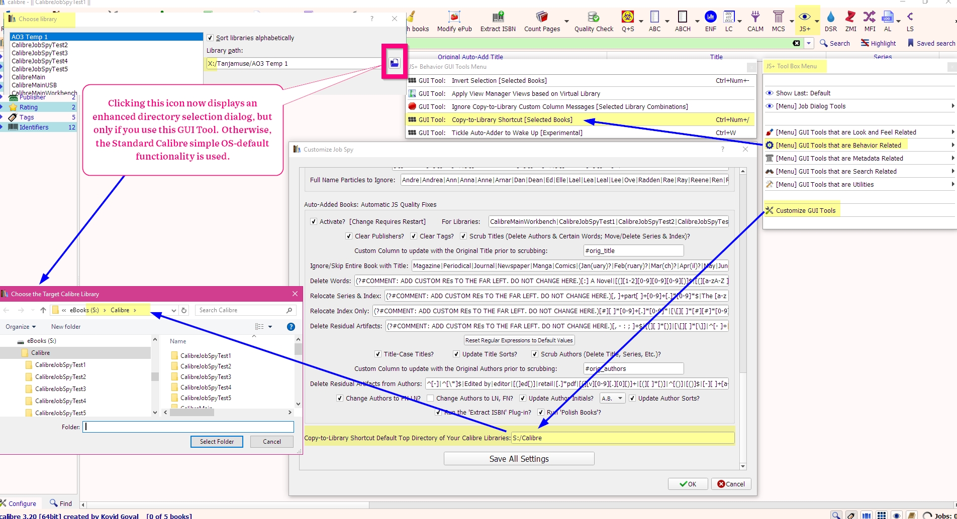

Version 1.0.108 Enhancement to Copy-to-Library Shortcut to use a new Library Selecti
Version 1.0.108 -2018-03-28 Enhancement to the GUI Tool 'Copy-to-Library Shortcut' to use a new Library Selection Dialog instead of the standard Calibre simple OS-specific dialog.
See the attached image.
DaltonST

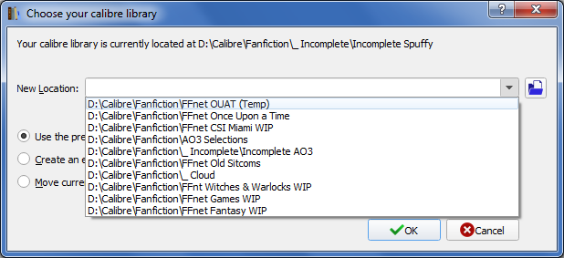

Every time I try to select another library now, it sends me back to my C: drive, instead of where I have all my libraries.
What I had hoped for was a way to select old locations like when I go to choose an existing library in "Choose Your Calibre Library".

See the image. You did not customze it as shown.

I have done what you suggested, but I still don't get the arrow and option for 10-20 previous selected libraries. Like in my screen in the previous post.
