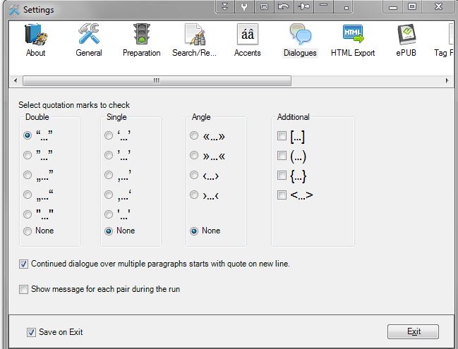

I have recently been working on a handful of books with lots of slang in it. The "Check Dialogue" is becoming nearly impossible to use because every other line is getting a hit:
“You doin’ anything tonight?”
“Where are you goin’?”
“I am ’bout to go down with ’em to the hotel.”
“That is freakin’ sweet!”
Perhaps it might be helpful to have some sort of functionality where you could add a list of words that are "valid" apostrophes?
Yeah, I can imagine that this would a big nuisance since these are not 'normal' words. Let me think about it and how this would work.
@Tex2002ans - if the book uses double quotes for dialogue (US style) and single quotes for dialectical contractions then why not select None for single quotes in Dialogue Check Settings.

Harder of course if book uses single quotes for dialogue (UK and the rest style), possessives and dialectical contractions etc
