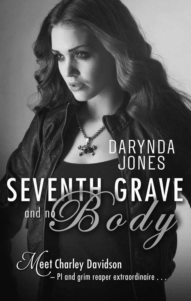

@davidfor: Yup, affects vanilla covers too. The closer I could get to describing it is banding, if that makes sense for grayscale .
You can replicate the effect by reducing a grayscale image to 16 shades without dithering (which I guess is basically what the software/hardware on the Kobo is doing, since dithering is relatively expensive).
ID:	133619   Click image for larger version
ID:	133620   Click image for larger version
ID:	133621   Click image for larger version

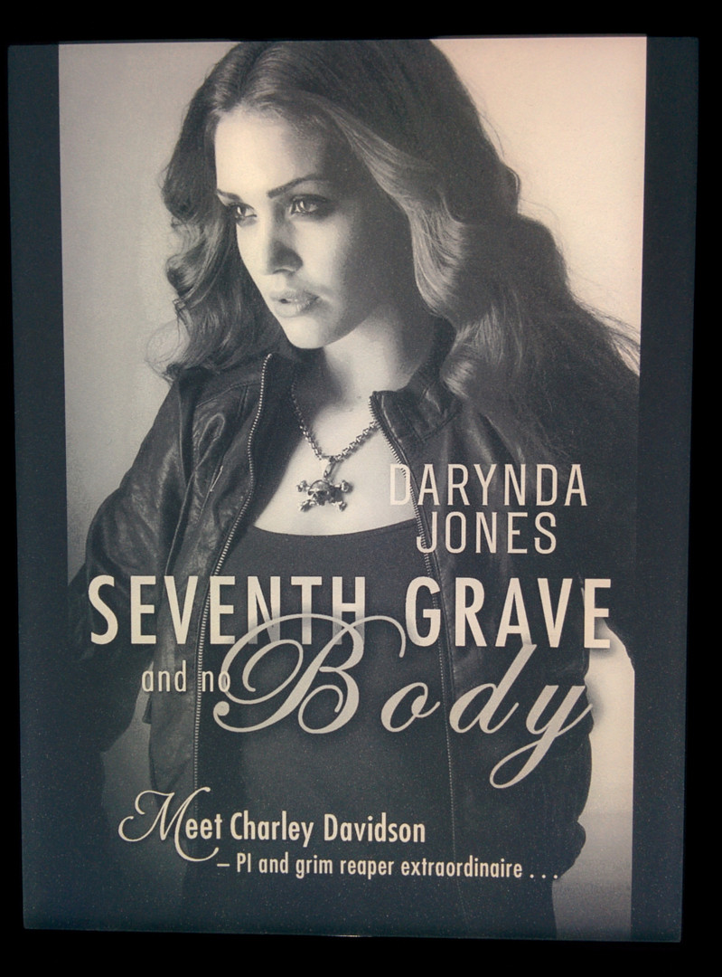

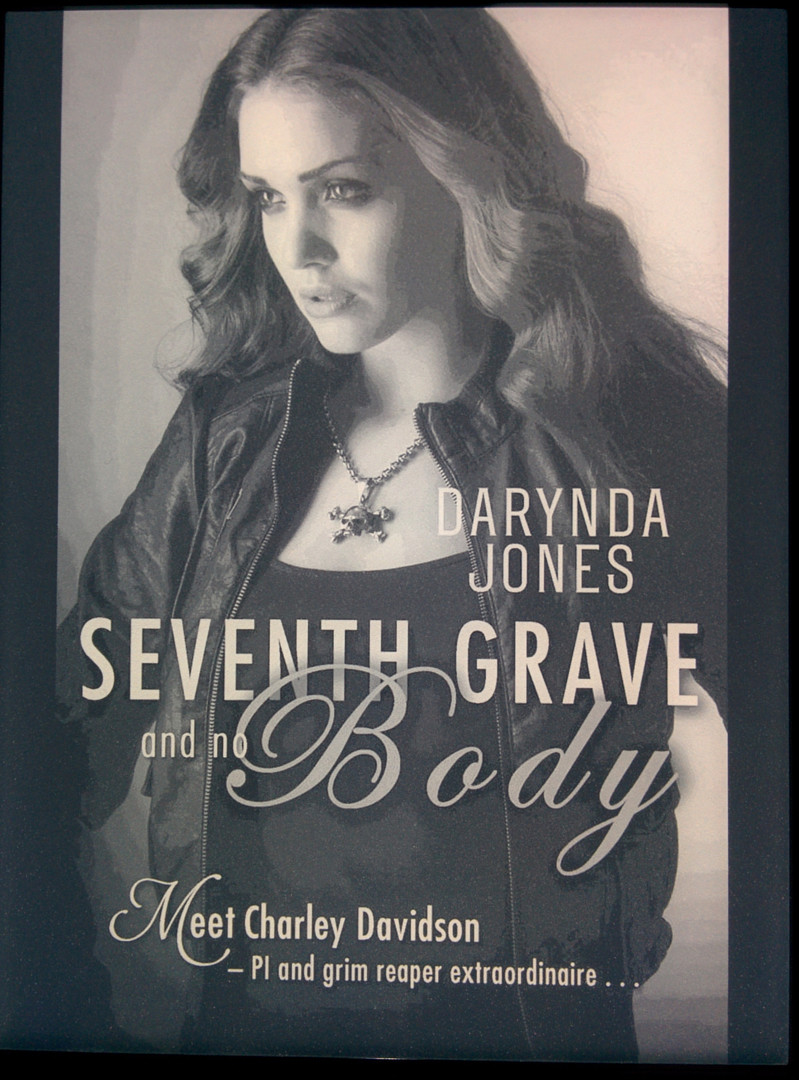

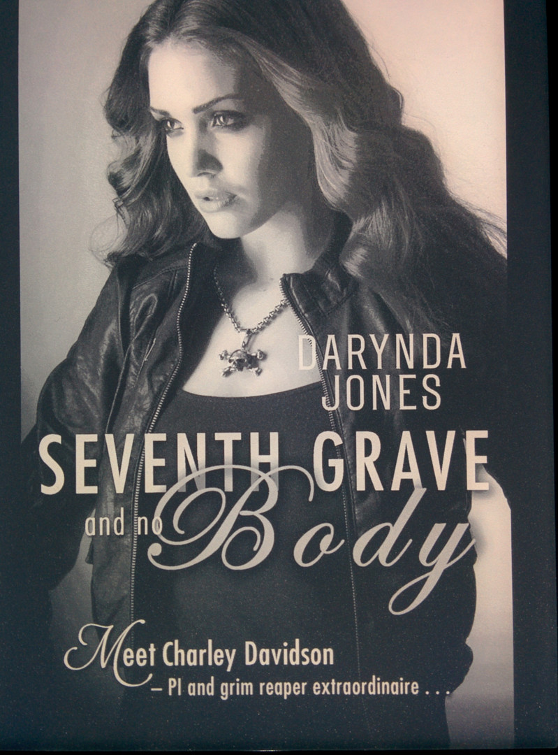

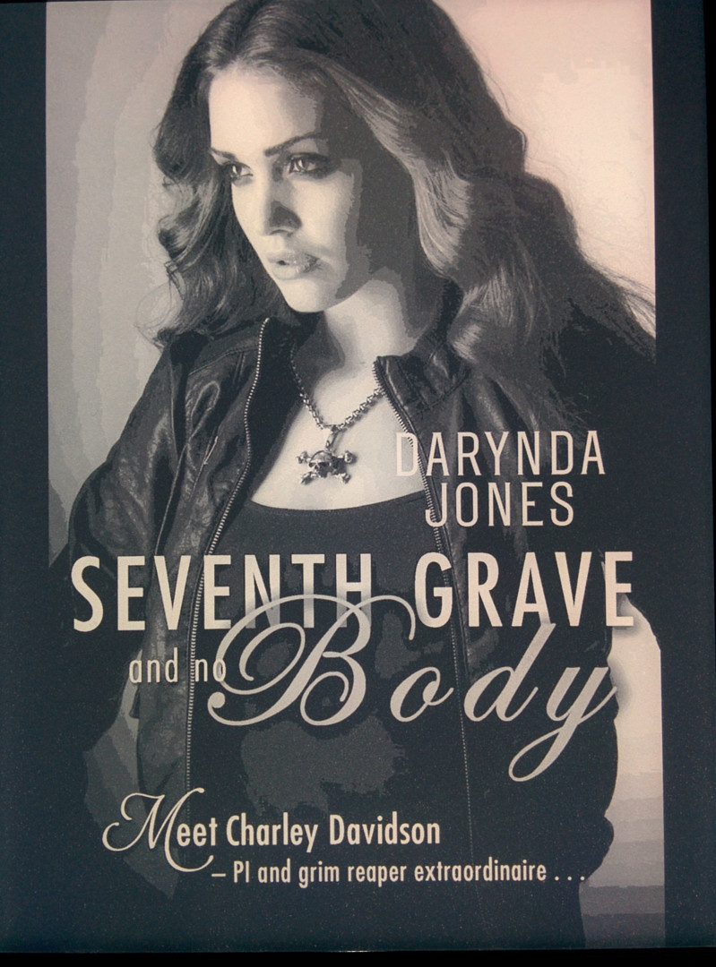

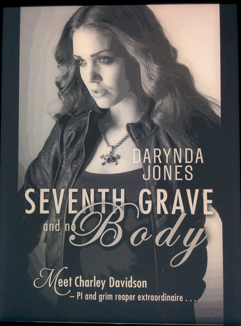

@jackie_w: Yep, throwing image 2 without processing at an eInk controller renders more or less like what image 3 looks like (albeit probably not as awful as that one, I chose something with gradients on purpose ).
As for the differences between 2 & 4 on an LCD, I'd recommend checking them at their original size, scaling algorithms have a tendency to smooth or exacerbate dithering patterns . [Some cheap LCD screens also have crappy internal dithering, which may not help, although that usually affects video more than fixed images].
On the other hand, throwing image 4 at an eInk controller should render much more like what image 2 looks like on an LCD than image 3 .
EDIT: See for yourself, attached the same thing formatted for the Aura H2O, feed it to pickel showpic. (And reset the rotation afterwards to unbreak nickel)
cat cover_dahlia_16c_dithered.raw | /usr/local/Kobo/pickel showpic
echo 3 > /sys/class/graphics/fb0/rotate
FWIW, because that's unusual enough to be annoying to find:
avconv -i cover_dahlia_16c_dithered.png -f rawvideo -pix_fmt rgb565 -s 1440x1080 cover_dahlia_16c_dithered.raw
Input PNG has to be 8-bit, even at 16c, or ffmpeg/libav chokes on it (ie. Image > Mode > Grayscale in GIMP), and it needs to be in landscape mode (90° counter-clockwise rotation)
EDIT²: And the requisite terrible cell-phone pictures .
EDIT³: That example also seems to unearth a gamma issue when the controller is fed a full-color image... ;o).
EDIT⁴: As usual, if you go the extra mile, and use IM all the way, with the specific eInk color palette, it's even slightly better .
convert cover.jpg -rotate -90 -colorspace Lab -filter LanczosSharp -distort Resize 1440x1080 -background black -gravity center -extent 1440x1080 -colorspace Gray -limit time 60 -dither FloydSteinberg -remap ~SVN/Configs/trunk/Kindle/Touch_Hacks/ScreenSavers/src/linkss/etc/kindle_colors.gif -define png:bit-depth=8 -quality 75 cover_h2o.png
ID:	133736   Click image for larger version
ID:	133737   Click image for larger version
ID:	133738   Click image for larger version
ID:	133739   Click image for larger version
