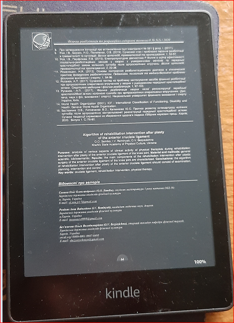

It doesn't work
Markus1 is offline   Reply With Quote

Originally Posted by Markus1 View Post
It doesn't work. Empty areas remain
Did you look at the PDF output from k2pdfopt on a PDF reader on your PC (e.g. view it in SumatraPDF)? Does it look right on your PC? What reader are you using on the kindle? Is it possibly the kindle reader that is the issue? Can you post your source and converted PDF (just a page or two, at least)?

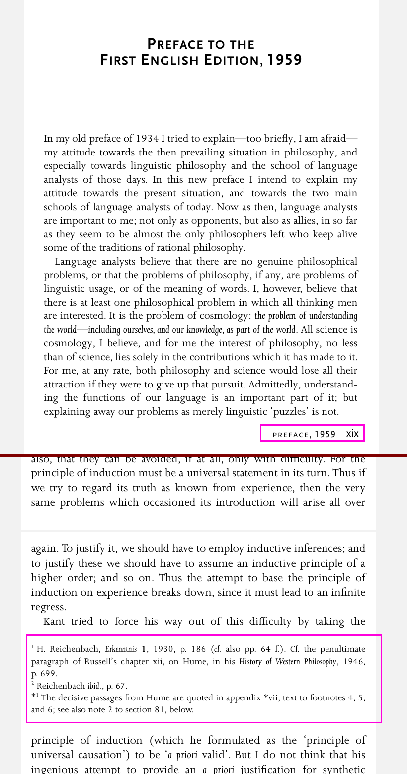

Hello,
I have a couple of questions:
1. What's the right way to remove a header that extends to 47pt? -mt 47p didn't work — for some reason, it's displayed at the bottom of the page
2. Is there a way to get k2pdfopt to move footnotes at the bottom of the page?
Here's the command I used:
k2pdfopt.exe -o test.header.pdf -p 13-20 -mt 47p -mode fw -ls- -om 0.2 -w 758 -h 1024 -dpi 213 -fc- input.pdf
Thank you.
Edit: And since footnotes obviously have a different height depending on the amount of text, I can't simply grab that section and move footnotes like Abbyy tries to do — sometimes successfully, sometimes not; Regardless, it moves them at the end of the chapter while I'd rather keep them in the page, for easier reading.
Does a PDF wizard know if it's possible to 1) search for all paragraphs that start with a exponented/superscript number and 2) cut those and paste them at the bottom of the page?
First question s/b easy--convert points to inches. 47/72=0.653 in, so -mt 0.653. The "p" is used for pixels, not points. See the "-h" option here. Let me think about on the other issue. I think maybe the best option is to use the -bp option? That will start a new output page for each new input page...? I don't really have any intelligence in k2pdfopt to be able to separate out footnotes and place them differently.

Thanks. That did the trick to remove headers.

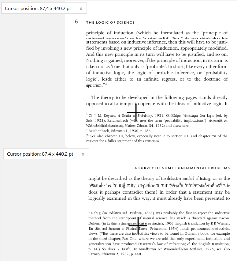

As for keeping footnotes at the bottom: When running pymupdf, I notice they are displayed in a smaller font size, possibly starting with a superscript (but not always: In this book, some footnotes start with a star followed by a superscript), so that would be a "simple" way to grab everything down to the end of the page, or move them all to the end of the chapter/book like Abbyy does and just include hyperlinks so the user can easily go back and forth.
blocks = page.get_text("dict", flags=11)["blocks"]
for b in blocks:  # iterate through the text blocks
	for l in b["lines"]:  # iterate through the text lines
		stuff = ""
		for s in l["spans"]:  # iterate through the text spans
			print("")
			#4.8 = 4.800000190734863
			if round(s["size"],1) == 4.8:
				print("Found footnote", s["text"])
			stuff += s["text"]
			print(stuff)
