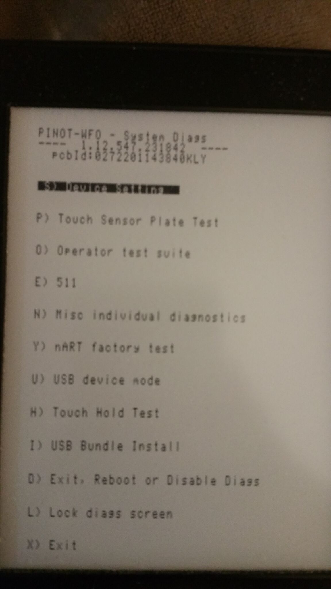

Need help please. The Paperwhite 2014 that we used in testing some of the jailbreak options at that time has developed an issue. It was not in use at the time and the battery needed charging so I plugged it into an outlet. When I came back to it saw the attached screen. I've tried several things to get out of it and nothing works. I'm not sure if this is an Amazon thing or some of the jb files/other files like this one which I did install if I remember correctly. I also had KUAL and other assorted goodies.
https://www.mobileread.com/forums/sho...postcount=1495
Rebooting helped nothing as it just goes right back in to the same screen. Any ideas? It hasn't been on wifi since before we did all the testing of the modified jailbreak. Would really like to get it working again. Thanks for any and all help.

Try:
'U' - Export USB
connect USB cable, Kindle to PC
delete any 'ENABLE_DIAGS' file(s)
safely remove (or eject)
disconnect USB cable
Follow the 'Disable Diags', and 'Reboot' path (I think there is another menu after making that selection.
Post your results.
