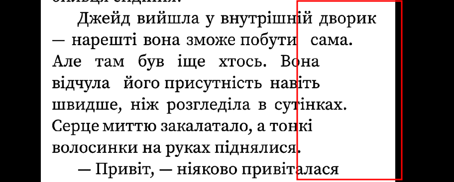

1. Output file size was significantly increased 5 Mb -> 117.8 Mb
2. Part of the letters moved to the next page. (see 2.png)

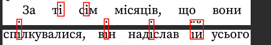

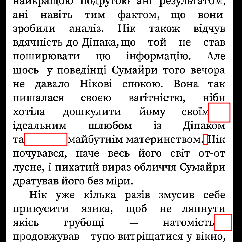

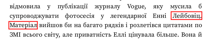

3. The gap between words is different if that word is from the end of the line in the original document.See 3_1.png (original document) 3_2.png (output document after wrapping)

1. The output file is the image. So I can use greyscale images with 4 bits (the maximum that my reader supports). Use the exact device resolution and DPI. And probably compression.
2. -om 0.03 fixed the issue.
3. Still can do nothing with that.
Have a good day.
As you figured out, the output size for bitmapped text re-flow is dominated by the resolution that you choose for the output page along with how many gray levels. If you can avoid text re-flow, you can likely reduce the size much further.
Where k2pdfopt breaks lines is controlled by the -gtr option. Read up on that option and you can try adjusting it.
Word spacing is probably most controlled by the output justification -- the -j option.

For file size, I prefer a bigger size to landscape mode. So I set the optimal resolution, dpi, and color depth to reach the optimal file size.
I have played a lot with that option but without any results. I prefer the full justification, but sometimes I get some results I can't understand.
In general, the text looks great, but some lines have a lot of space at the end. At the same time, other pages look pretty good. And about the gap between words on the same line that can be quite different. Looks like it was calculated before re-flowing the text.

You could also try adjusting the -ws (word spacing) value.

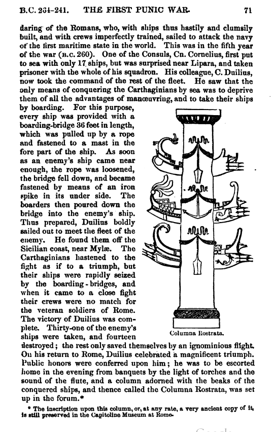

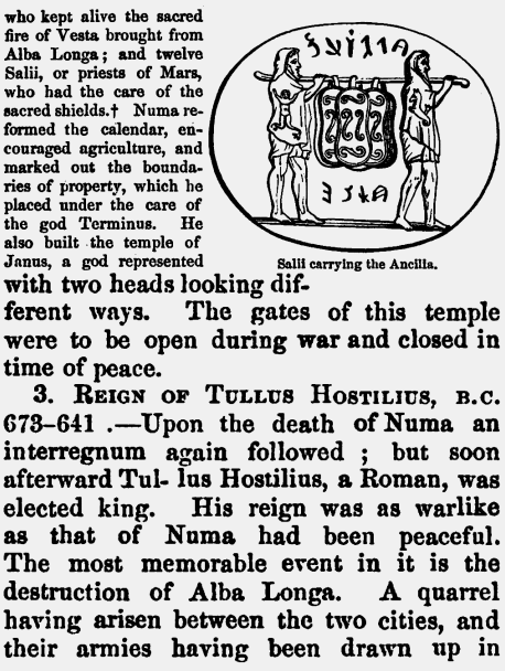

Hello. I liked this software very much and tried different command line settings for a whole day. Everything is good, but whenever an image is inserted into the text, I could not make the software detect this image as a separate block. Do you think there is a way to do this? I added screenshots. I tried -cg -ch etc. and also -rsf and -to command line options with no success.
I mean I couldn't make the software detect both the image and the text next to it as seperate blocks. So the text next to the image is always in small font size. I beg your help. Thanks beforehand.
tetraxi33 is offline   Reply With Quote
Okay--I made a PDF of your screen shot (at 96 dpi) and was able to get k2pdfopt to parse it the way you want with this command:
k2pdfopt -sm -crgh .01 -gtr .02 -f2p -1 sample.pdf
The -sm option just creates a PDF showing how k2pdfopt parsed the page--this is a useful debugging tool.
The -crgh option default is .013 (1/72) inch. I lowered it. This makes it easier to detect a 2-column sub-section of the document. See this page for how it is used.
The -gtr option makes it easier for k2pdfopt to detect the row breaks since your text lines are kind of crowded together. The default value is .006. The higher value means there can be more "black" in the gaps between rows--they don't have to have pristinely all-white gaps between them.
Finally, -ftp -1 shrinks the figures onto a single page if they are extra tall.
Thank you sir. It seems that carefully tweaking the settings can make almost any pdf readable.
