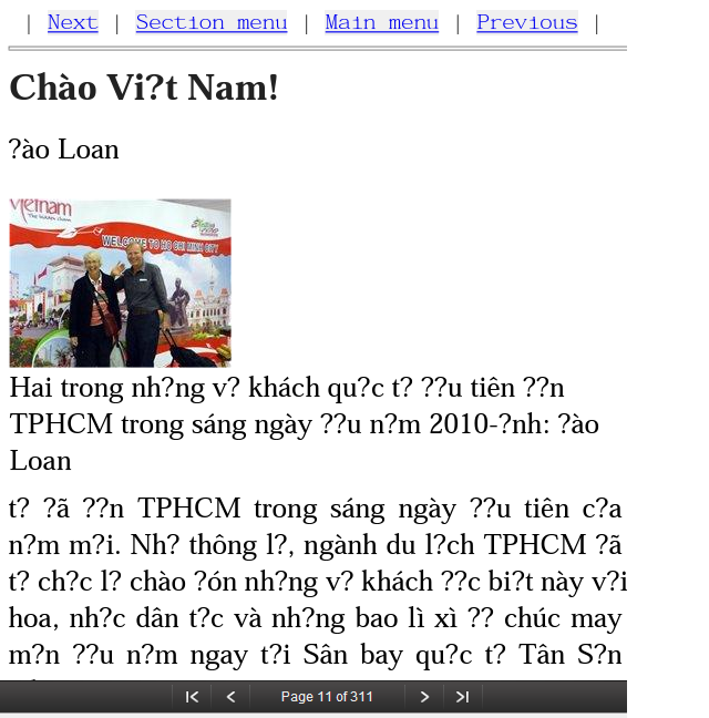

Yep. I've tried but no chance. I think epub files fetched from different RSS sources that have different structures, depend on the HTML of the website. So that some words don't display correctly [?]. Please view the sceencap.
You'll just have to put the font family declaration into whatever CSS elements need it.

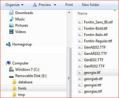

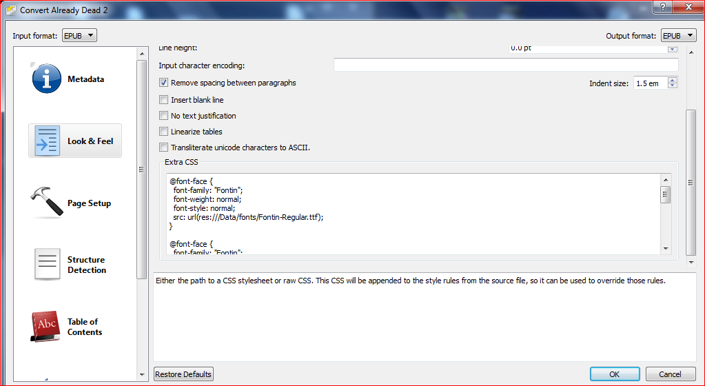

Zelda sent me here because I'm still having problems. I have PRSPlus installed my 505 if that makes a difference. Here's my stuff:
@font-face {
  font-family: "Fontin";
  font-weight: normal;
  font-style: normal;
  src: url(res:///Data/fonts/Fontin-Regular.ttf);
@font-face {
  font-weight: bold;
  font-style: normal;
  src: url(res:///Data/fonts/Fontin-Bold.ttf);
@font-face {
  font-style: italic;
  src: url(res:///Data/fonts/Fontin-Italic.ttf);
@font-face {
  font-family: "Fontin Sans";
  font-weight: bold;
  font-style: italic;
  src: url(res:///Data/fonts/Fontin_Sans_BI.otf);
Edit: I realized I left the "body" part off the end but I added it and tried again with no luck.

Old 01-06-2010, 10:33 PM   #210
daffy4u
I'm Super Kindle-icious
daffy4u's Avatar
Posts: 6,734
Karma: 2434103
Device: KDXG, KT, Oasis
Nevermind, I got it. When I added the body information, I left out a space.
I typed "body{" instead of "body {".
