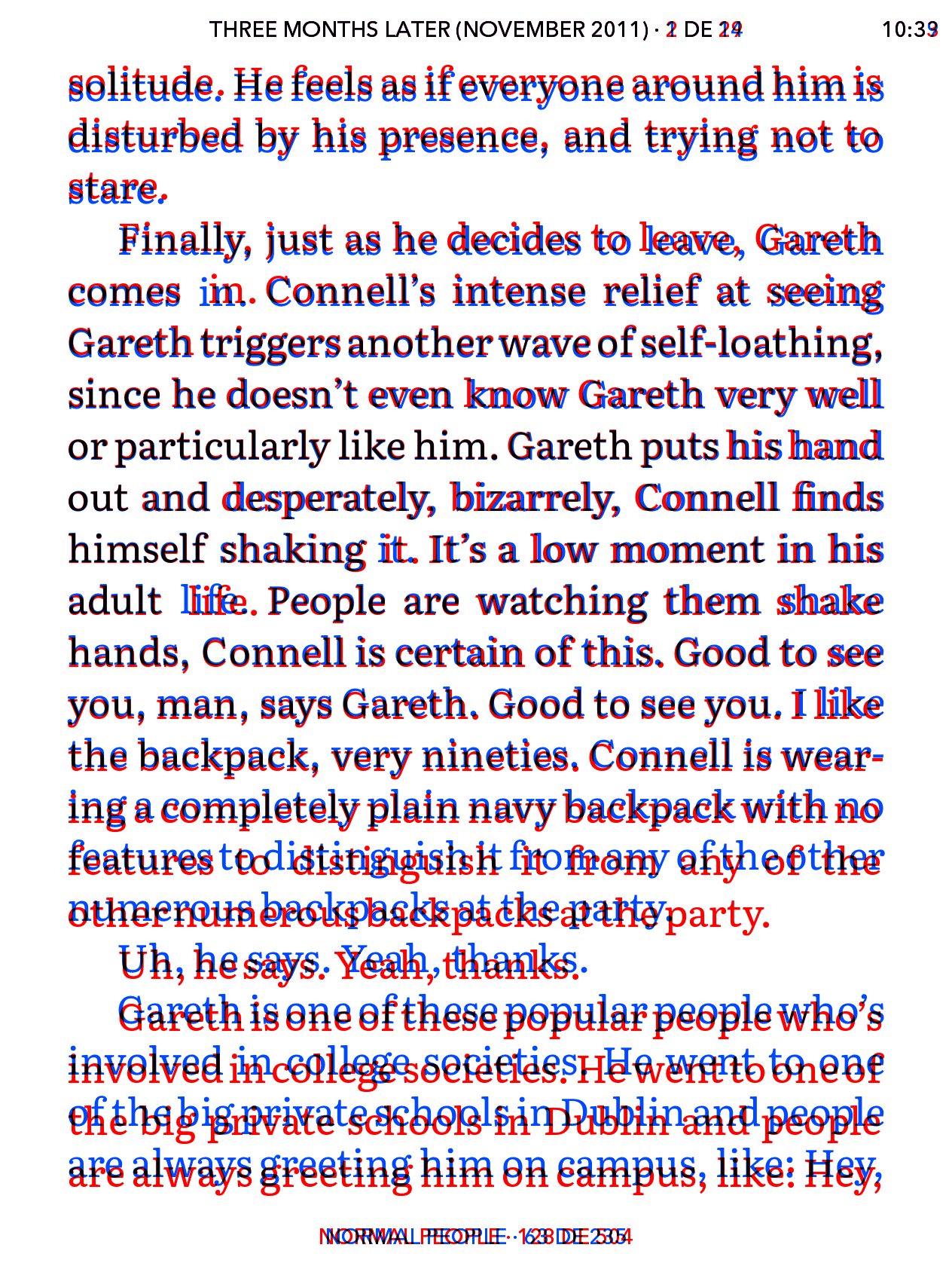

I've been doing some tests with this but I never seem to get ACCESS to look as nice as RMSDK.
The closest I've been able to making it look as good is the comparison below.
BLUE = ACCESS
RED = RMSDK
BLACK = OVERLAP
The font is LiterataTT and I'm using geometricPrecision and -0.06 word spacing - any more and words start getting too close for comfort.
