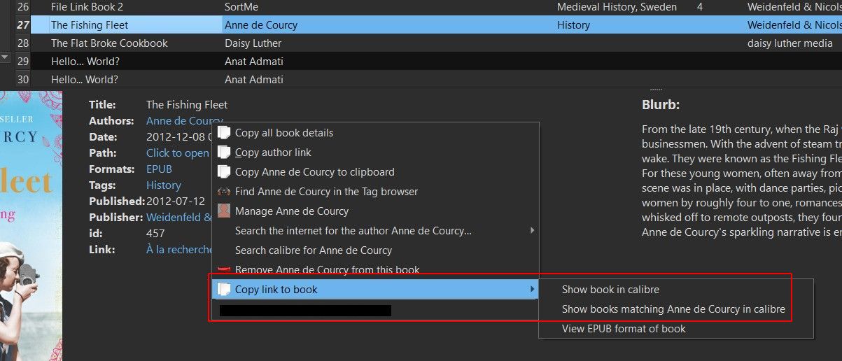

Would it possible to implement the same Copy link to book… options that Kovid has added to the Book Details, to the CalibreSpy book context menu, viz:

Usage: it will make it a lot easier to create links between books in different libraries

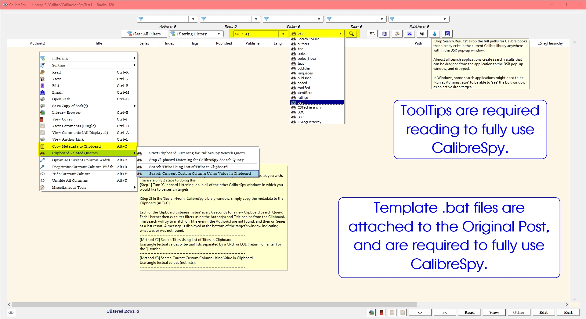

"The calibre:// URL scheme" ?
To clarify, are you requesting CalibreSpy to support "The calibre:// URL scheme" as defined in https://manual.calibre-ebook.com/url_scheme.html ?
If so, that is a big ask, since CalibreSpy does not use Calibre's gui or guidb or gprefs or server or any other "live" part of Calibre.
CalibreSpy is explicitly designed to run when Calibre is not running at all, anywhere, in any way, since CalibreSpy was intended to be run from a .bat file multiple times simultaneously using only Calibre's metadata.db as a stand-alone SQLite database.
Could you clarify your request, and explain exactly how and when you would theoretically use what was copied to the OS clipboard from CalibreSpy?
Also, how that is not redundant with performing CalibreSpy multi-Library searches for matching books using "Clipboard Search Queries" while simultaneously viewing multiple Libraries in CalibreSpy as shown in this video example from 2018: https://www.mobileread.com/forums/attachment.php?attachmentid=166302&d=1536956413
As well, CalibreSpy has my Drop Search Results plugin embedded with the DSR icon shown in the CS window. Simply Drag a book's textual path from any source that supports Dragging to the CS DSR icon.
Or, simply copy a books partial path found anywhere into the CalibreSpy Regular Expression Search box, click the binocular icons for "path", and it will filter based on that search.
Or,...

Sure.
Background:
You might recall that want to keep extra data about 'entities' related to 'book' metadata - such as authors, publishers, tags even. I tried using the Entities Manager plugin for a but it really didn't suit my style of working.
For Authors I have been pasting Evernote Note links into the Link field in Manage Authors, that allows me to click an Author name in the book details panel and view what I have for that author in my EN Authors notebook (obits, bio, web sites etc). But I had no easy way to do the reverse, i.e see a list of books I had for that author - I had a kludgey scheme of using calibre-server for a while, but like most kludges it was a PITA to maintain, and it was 'tied' to the version 2 read only server.
A week or so after Kovid implemented the calibre:// URI protocol handler, Evernote published a major new version - a 'feature' of which is to end support for local notebooks and force everything into their cloud - grrrh.
So I exported my Author Notes from Evernote into MHT 'files' and used them to create entries in an Authors library - one 'book' per Author.
In my content libraries (Books, Journals, Media) I have replaced the evernote://blah-blah links in Manage Authors with calibre://show-book links to the relevant record in my Authors library, and in the Authors library I have put a calibre://search/ link into the Manage Author link fields.
The easiest way to get the calibre://blah-blah links is to use the "Copy link to book" options Kovid has added to the Authors context menu in Book Details, viz:
Name:	Screenshot 2020-12-07 084939.jpg
These options yield the following
calibre://show-book/_hex_-54657374/457
calibre://search/_hex_-54657374?eq=617574686f72733a223d416e6e6520646520436f7572637922
So, what I was looking for is a "Copy Calibre links" item in CalibreSpy's context menu, with "Show Book" and "Search for <author name>" options.

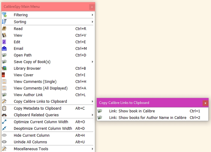

CS: New Menu Items Concept
Does the attached image show what you are looking for?

Almost, what it doesn't do is cater for multiple authors. I would settle for just the first author, I would prefer separate options for each author, viz:
Link: Show book in Calibre
Link: Show Books for <author_name_1> in Calibre
Link: Show Books for <author_name_2> in Calibre
What I wouldn't want is any 'AND/OR" combinations
And I am not fussed about having keyboard shortcuts for everything, I use the Menu Key to pop context menus and then the arrow keys.

Version 1.0.84 "Copy Calibre links" item in CalibreSpy's context menu
Version 1.0.84- 11 Dec 2020 "Copy Calibre links" item in CalibreSpy's context menu, with "Show Book" and "Search for <author name>" options.
These URL Links are based on https://manual.calibre-ebook.com/url_scheme.html.
Obviously this can be used only by Calibre 5.7+, although CalibreSpy will still generate them properly even with a minimum version of Calibre 4.6.
To ensure the accuracy of the search results in Windows 10 users, the "author name" query (only) is shown as hexidecimal so that the Windows 10 command line does not corrupt the query when parsing it to pass it to Calibre.
CalibreSpy Example:
Book ID: 15 calibre://search/CalibreLibraryCodes?q="id:15"
Book Author Name: Krasznahorkai, László
Calibre Link's url: calibre://search/CalibreLibraryCodes?eq=617574686f72733a223d4cc3a17 37a6cc3b3204b7261737a6e61686f726b616922
Results in the Calibre GUI SearchBar: authors:"=László Krasznahorkai"
Note: If you were to use the Calibre GUI Book Details "Copy Link" function, it would be in a totally different format that only Calibre itself can create due it its support of the Calibre Server library_id (which CalibreSpy does not use).
