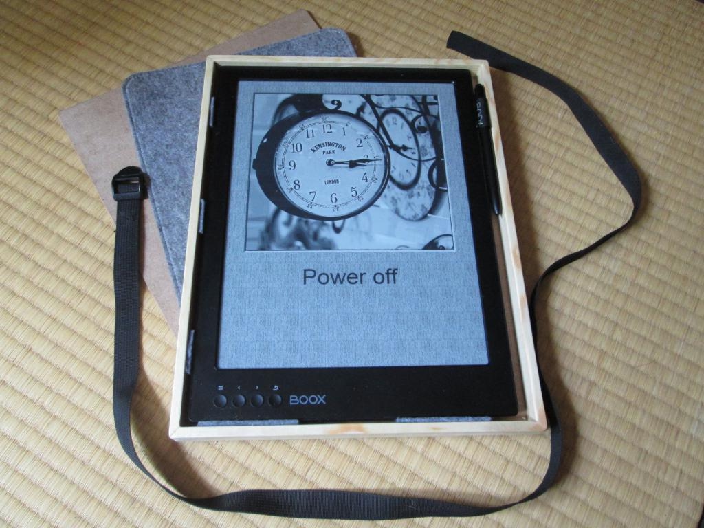

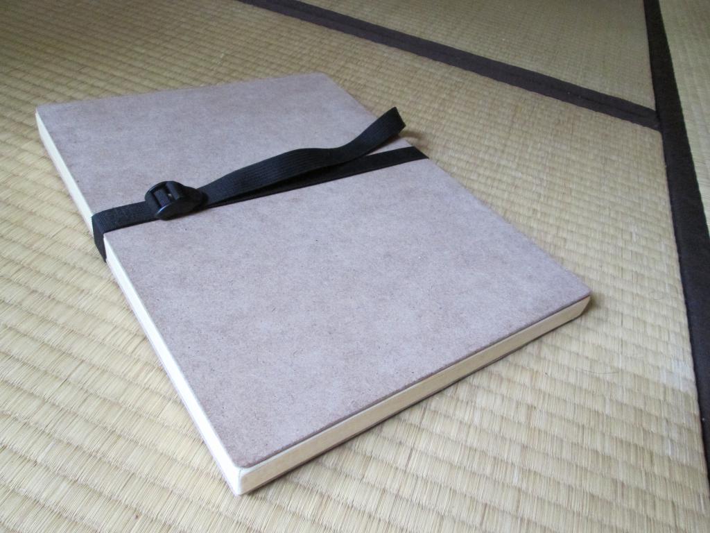

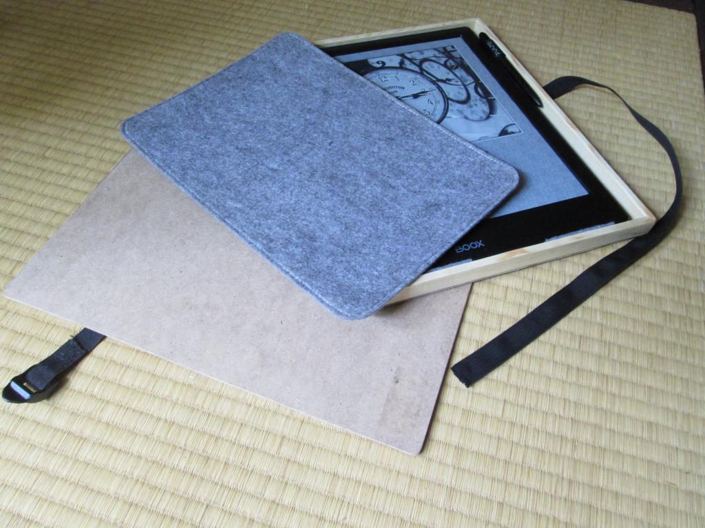

Some hardboard. Some pine. A bit of glue. Some finishing nails. A salvaged grey felt sleeve. And a strap. That was how I approached the problem.

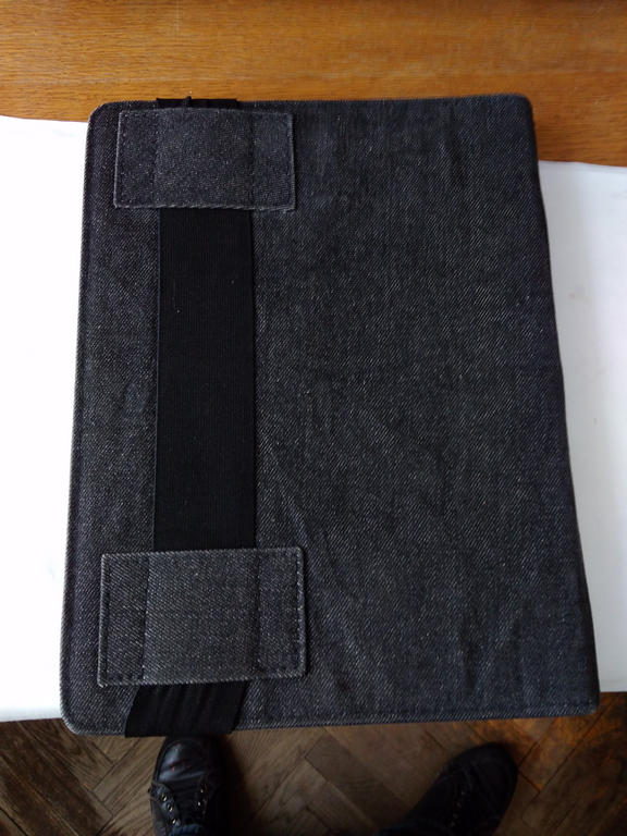

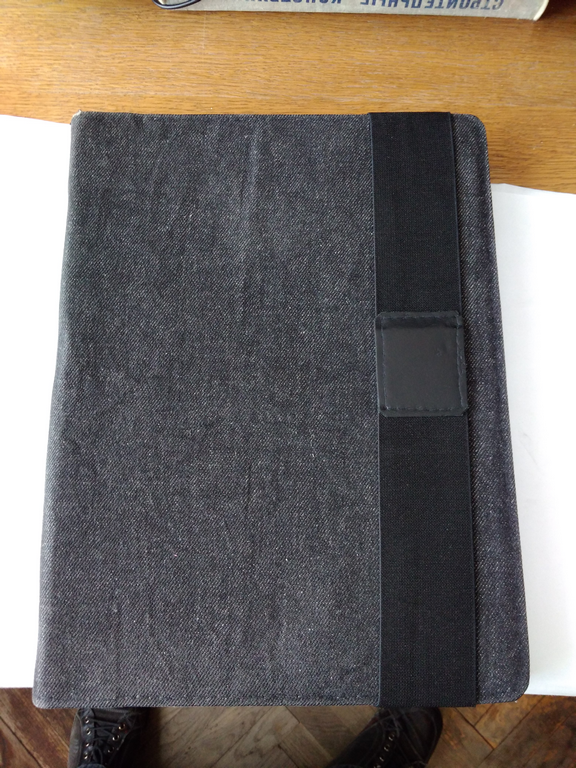

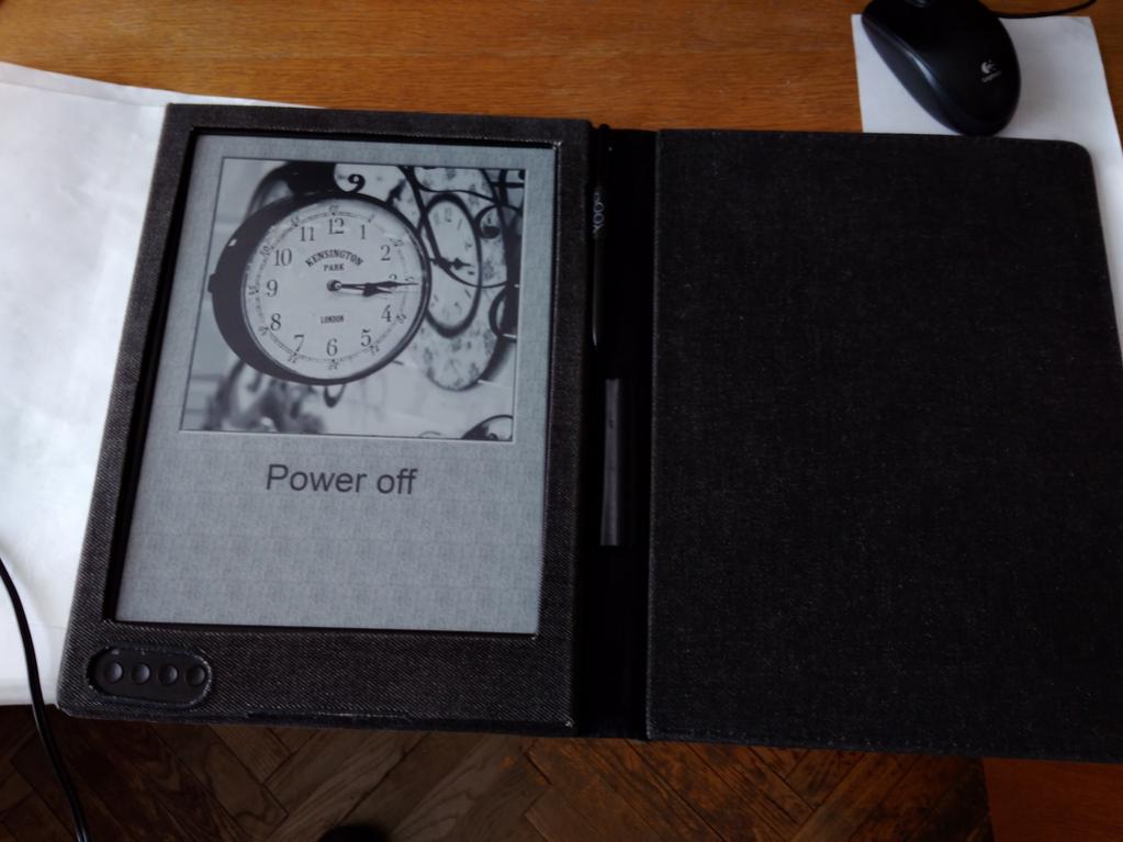

Jean, hardboard, glue. Weight is much larger than before. One year it lives in a backpack - it's all right.

Nice design. And undoubtedly lighter than mine. Glad to hear that it is holding up.

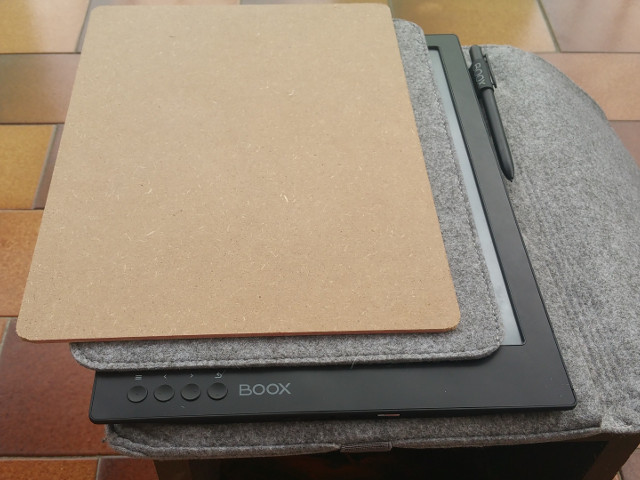

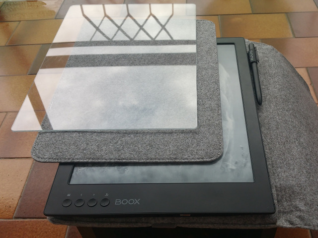

Here are the DYI solutions involving just cutting widely available "light" rigid sheets:
a 230x315 mm Medum Density Fiberboard, 3 mm thick,
and a 230x315 mm synthetic glass, 2 mm thick.
The comfort about MDF is that you can probably have them cut professionally to your need at your local DYI shop. I then rounded the edges, in both cases, using a Dremel with sand paper on a cylinder.
The 230x315x2 synthetic glass weighs 160g, the 230x315x3 MDF weighs 170g.

Yup. That's a good lightweight solution to protect the screen.
Had considered doing that. However, my backpack can get pretty full of various stuff and I didn't want anything pressing unnaturally against my Max. Figured a case would isolate it best. Now I have no worries. It's protected from all angles.
The weight wasn't a huge consideration because I'm not going to be attempting to read it one-handed on a crowded train.
