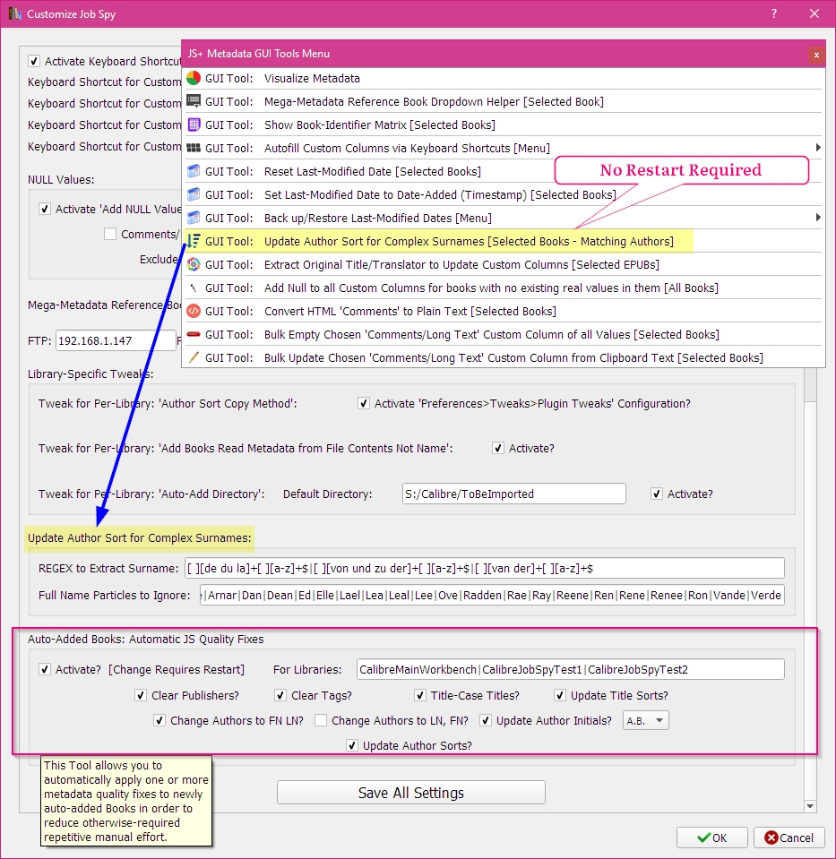

Version 1.0.98 - New GUI Tool: Update Author Sort for Complex Surnames
New GUI Tool: Update Author Sort for Complex Surnames.
This Tool uses a Regular Expression defined in Customization to extract surnames (last names).
Example: Author 'Walter de la Mare' could be changed to have an Author Sort of 'de la Mare, Walter'.
Refer to the attached image for a complete explanation and example.

Version 1.0.101 Calibre Minimum Version now 3.17
Version 1.0.101 - Calibre Minimum Version now 3.17 due to technical changes in backend.py by Calibre. Upgrade Calibre before upgrading Job Spy.
New Customization Option related to the GUI Tool 'Update Author Sort for Complex Surnames'. See the attached image.
Added:
Based on using a "real" Calibre Library with almost 16,000 "real" Authors, and running this GUI Tool while in Debug mode so as to be able to view exactly what was changed, and to what, I have modified the default customization values for future JS versions for this particular GUI Tool to be:
  • [ ][de du la]+[ ][a-z]+$|[ ][von und zu der]+[ ][a-z]+$|[ ][van der]+[ ][a-z]+$
  • Andre|Andrea|Ann|Anna|Anne|Arnar|Dan|Dane|Dean|Ed| Elle|Lael|Lea|Leal|Lee|Ove|Radden|Rae|Ray|Reene|Re n|Rene|Renee|Ron|Vande|Verde
Note: Mobilread.com automatically adds a space when a literal value gets too long from its perspective, so any "space" you may see in the "ignore" values above (e.g. '| Elle|' or '|Re n|' ) should NOT be used in JS. The lower value should have no spaces in it.

Version 1.0.104 New GUI Tool: Automatically apply fixes to auto-added books
Version 1.0.104 -2018-03-13 New GUI Tool: Automatically Perform Various Quality-Check Plug-in Type Fixes after each 'Auto-Add Books' event. Also, default values improved for GUI Tool 'Update Author Sort for Complex Surnames', and that Tool now only updates Selected Books (not All Books). No restart is required as well.
DaltonST
