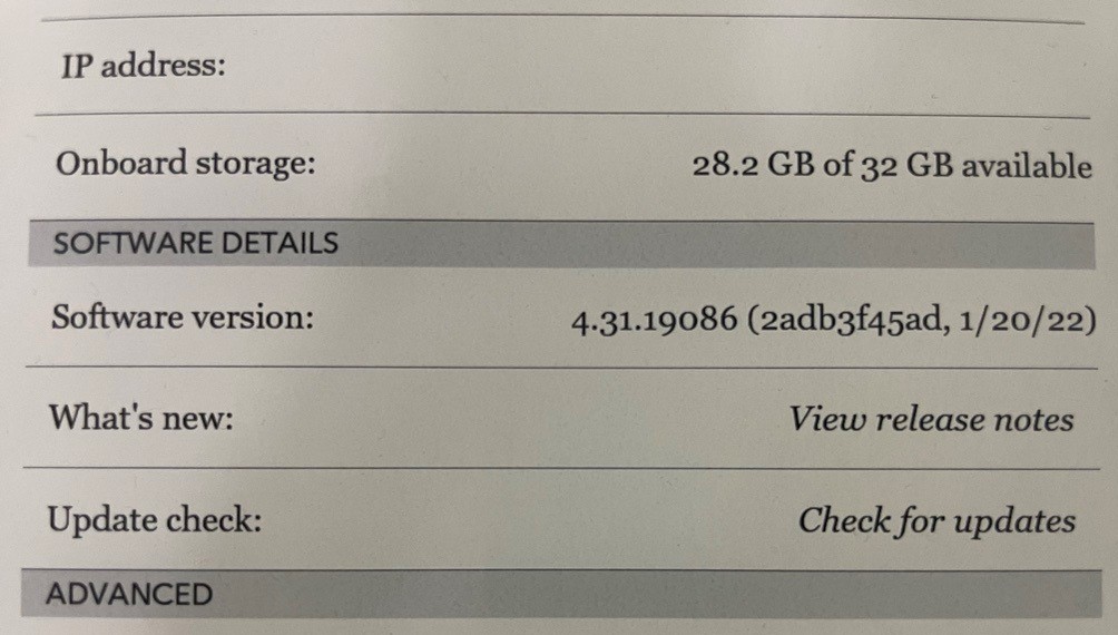

19086 is the version that's being shown on my device as shown in the attached image.
Attachment 192922
4.31.19086 is the Kobo firmware version and has nothing to do with NiLuJe's packages.
