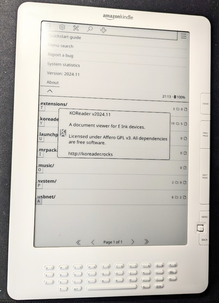

I`m running Kindle DX 2.5.8 JB, MKK, KUAL, KoReader
all works great ( updated date yaaay ) but when exiting KUAL I have to reinstall MKK again for some reason.
after exiting KUAL 2024.11 ( legacy ) the TEST KINDLE INSTALLATION RESULT document appears and MKK devCert must be installed again to be able to enter KUAL
just to add this device is not and has not been and will not be registered
in the meantime followed this guide to register device ( registration worked ! )
https://www.mobileread.com/forums/sh...ad.php?t=87336
registering device fixed the issue
