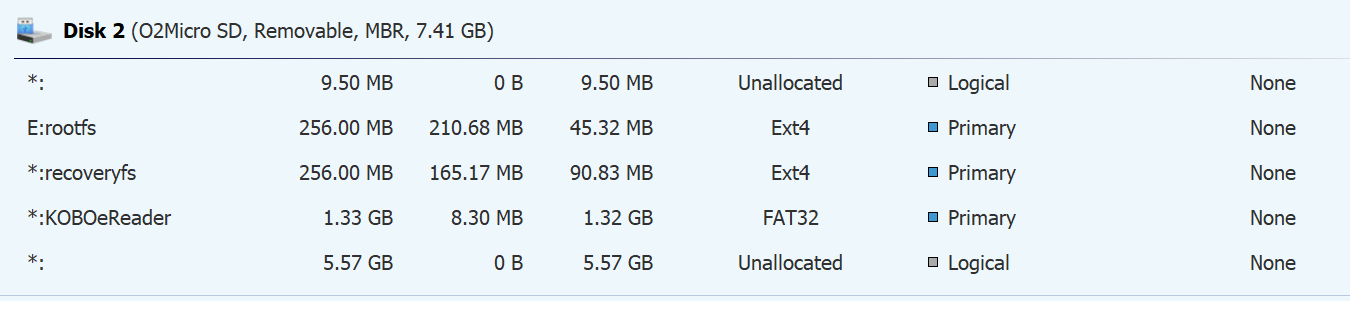

Old 07-01-2018, 05:35 AM   #204
4rchibald
4rchibald began at the beginning.
Posts: 6
Join Date: Jun 2018
Device: Kobo
Hi.
Thanks for the file. I have created new image on an 8gb card, which looks like the snapshot below, but I can't get the kobo to work.
I tried soft and hard reset (reset button, light switch+on), but none works.
Unless I'm not doing something right, the Kobo looks to be dead.
4rchibald is offline
Old 07-01-2018, 06:21 AM   #205
davidfor
Posts: 24,905
Karma: 47303826
Location: Sydney, Australia
Originally Posted by 4rchibald View Post
Hi.
That looks OK. What actually happens when you try to turn it on? And you have charged it?

Old 07-01-2018, 08:39 AM   #210
Atilla
Atilla ought to be getting tired of karma fortunes by now.Atilla ought to be getting tired of karma fortunes by now.Atilla ought to be getting tired of karma fortunes by now.Atilla ought to be getting tired of karma fortunes by now.Atilla ought to be getting tired of karma fortunes by now.Atilla ought to be getting tired of karma fortunes by now.Atilla ought to be getting tired of karma fortunes by now.Atilla ought to be getting tired of karma fortunes by now.Atilla ought to be getting tired of karma fortunes by now.Atilla ought to be getting tired of karma fortunes by now.Atilla ought to be getting tired of karma fortunes by now.
Posts: 225
Karma: 619496
Device: Kindle 3, Kindle 3 3G, Kobo Touch, Playbook,Kobo Clara HD,Kobo Libra 2
Not sure if it is related but I noticed from the picture you did not extend the kobo partition.
Atilla is offline
