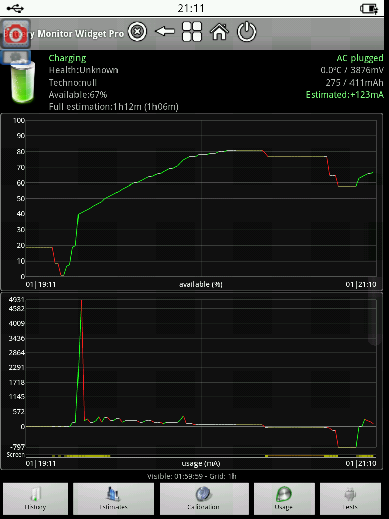

Battery
And an other consideration ...
In the attached screenshot, you can see some abrupt angles on the battery curve.
I check the curve with an other program also, and it was the same.
So either the system gives to the programs strange values, or the battery management is working very weird on Android.
embryo is offline   Reply With Quote
