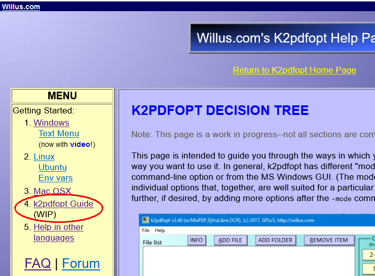

Originally Posted by 0jay View Post
I general guide’d be good. If there isn’t one it might be an idea to write one. I’d volunteer but have at thesis to write this year, might be time enough after that.
I had started a guide a while ago and never made it available. I've added it to my help pages, though it is still a work in progress.
Old 02-19-2023, 05:35 AM   #2007
