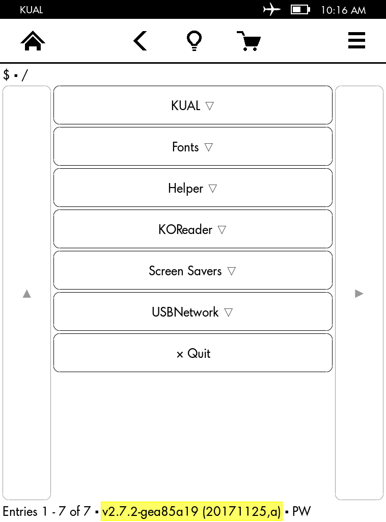

Minor issue with version display in KUAL
Does anyone have problem with version display in KUAL home screen?
I am using PW 1st generation. I downloaded the newest version of KUAL from link below, and I copied KUAL-KDK-2.0.azw2 into document folder. The version of KUAL should be v2.7.12-g9623dd8-20181108, however, it is shown as 2.7.2 in the home screen of KUAL. Seems like this issue was there for more than 1 year.
http://cloud.ak-team.com/
Did I miss some step like refresh buffer?
Thanks
Thanks
Install the version of KUAL released in NiLuJe's snapshot thread:
https://www.mobileread.com/forums/sh...d.php?t=225030
And then report back if the problem continues to exist.
Thanks
Just have more tests.
What I did in the past was simply copying KUAL-KDK-2.0.azw2 into document folder in Kindle, and I never ran Update_KUALBooklet_<version>_install.bin. When a new version of KUAL was released, I replaced KUAL-KDK-2.0.azw2 with new version, and the version number was never updated.
I have just ran Update_KUALBooklet_v2.7.12_install.bin, and the version number is displayed correctly now. Strange thing is the README file doesn't ask me to do so for PW.
I deleted KUAL-KDK-2.0.azw2 from document folder, and copied it again into this folder, and the version number was correct.
So, I think the problem can be summaries as, the version number would not be updated if replacing KUAL-KDK-2.0.azw2 without running Update_KUALBooklet_<version>_install.bin.
Thanks.

Old 11-18-2018, 08:48 PM   #1961
NiLuJe
BLAM!
NiLuJe's Avatar
Posts: 13,507
Karma: 26047224
Location: Paris, France
@mimihuhu: Either you were checking out an old Booklet version while having just updated the Kindlet version, or vice-versa.
As far as the Kindlet version is concerned, it may require a framework restart to actually cause it to be properly reloaded. Something which is inherently part of the MRPI (or UYK, since that's a full restart) process, hence things working properly after installing the Booklet version. (Which, incidentally, also fixes the potential Booklet/Kindlet version mismatch ).
Hi NiLuJe, thank you so much for your quick reply. However, I think restart framework won't refresh the version number. I noticed the version number never got updated in the past year, though I replaced KUAL-KDK-2.0.azw2 from one version to another. The framework should restarted several times in the fast year, since installing other programs (like python) would restart the framework. My kindle was running out of battery, and the framework should had a full restarted after recharge. I never got version number fixed in the past year until running Update_KUALBooklet_v2.7.12_install.bin just now. Thanks.

@mimihuhu: Then you had two copies of the AZW2, and ended up always launching the old one. (There was a filename change at one point).
(The code is literally the same, which makes this a PEBCAK by design).
