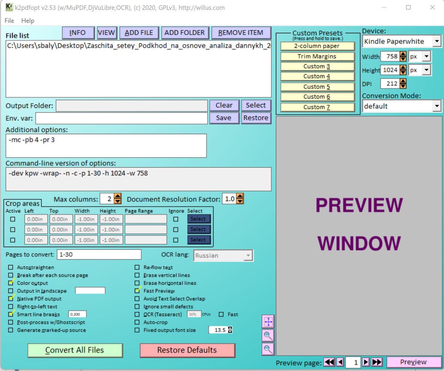

hi, I just started using this utility. I can't convert this book. The font is still small. i have a poketbook 628 758 × 1024, 212 dpi, tell me what I do wrong.
[Mod edit: snipped possibly copyright book]

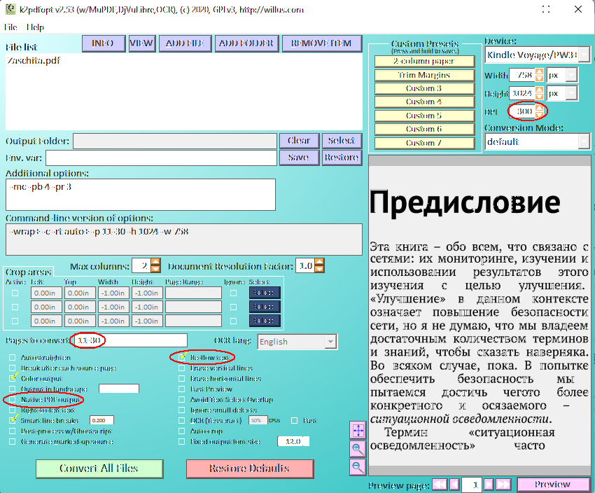

The important thing is to disable native PDF output and check the "re-flow text" box. See attached screen shot. I also bumped up the dpi to 300--this will effectively control the text size.
If you want to keep it in native PDF, your only option for bigger text is to rotate so that you are viewing the document in landscape mode. K2pdfopt cannot re-flow text with native PDF turned on.
