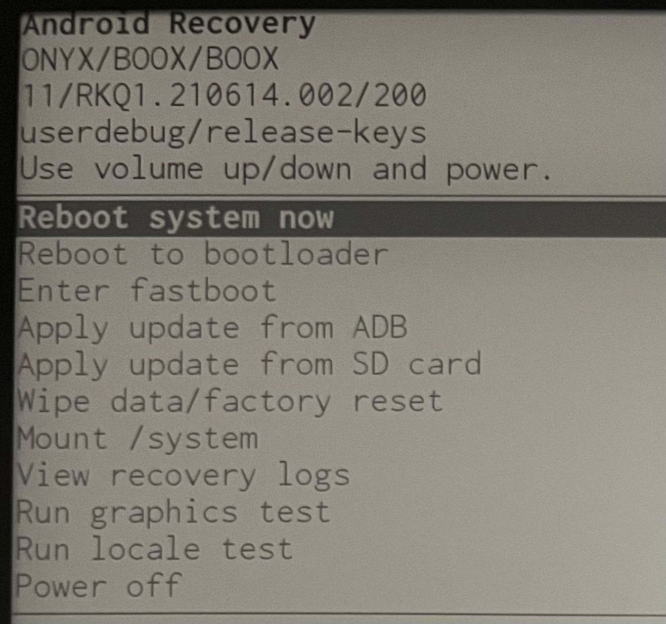

@Renate, your tool worked like a charm! Thank you! I was able to grab an image off my NA2+ and patch it. However, for some reason I cannot get into the bootloader for my device. I can get into fastboot by using "adb reboot fastboot" or by using the recovery menu and selecting "Enter fastboot". But whenever I try to reboot to bootloader, it just hangs at the Onyx logo screen. If I try to run the next command in my terminal (fastboot boot magisk_patched.img) it says "< waiting for device >" and I have to restart the device to get it back.

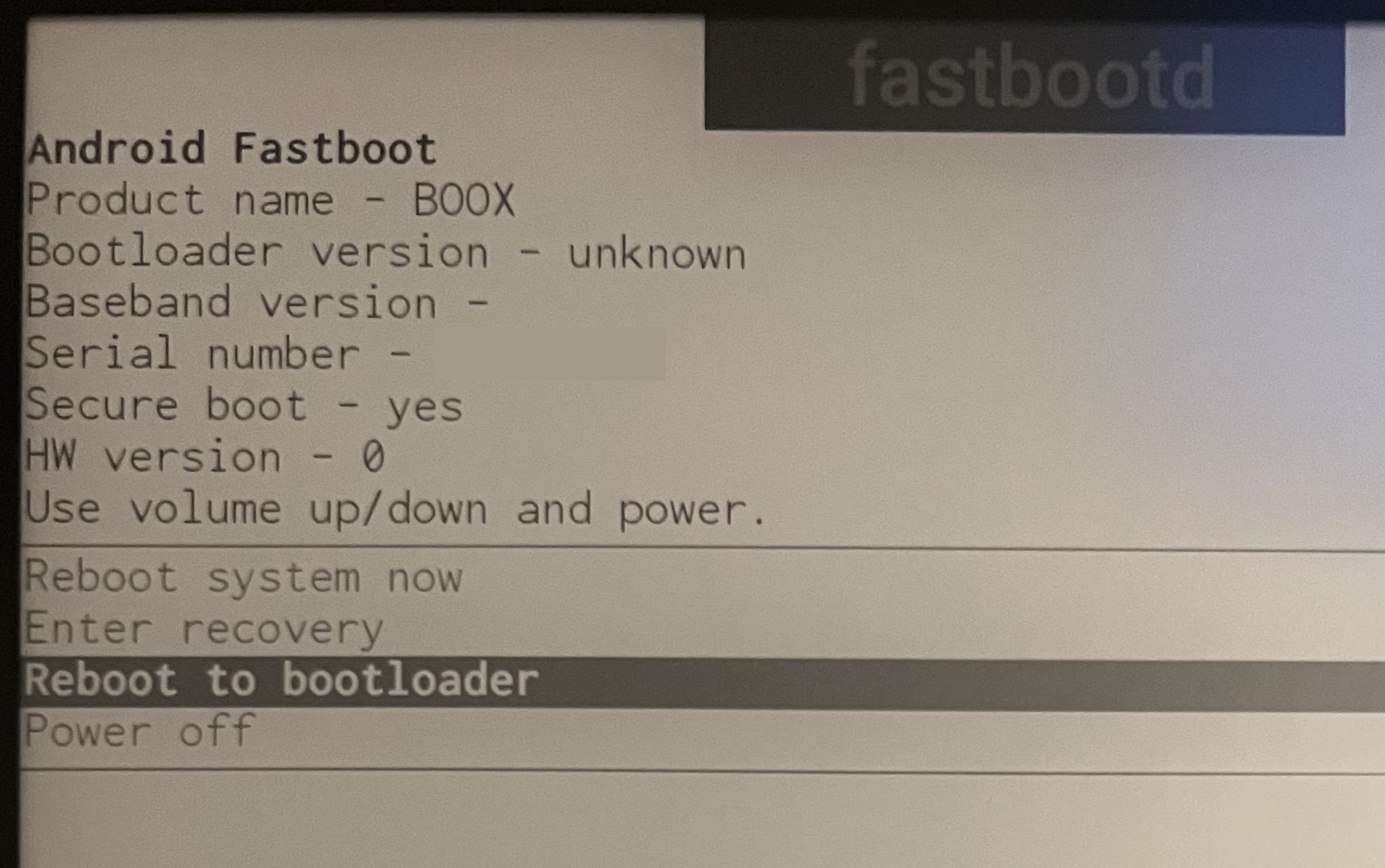

I meant to attach these screenshots in case they help.
Name:	adb reboot fastboot.jpg
ID:	196805   Click image for larger version

I know you said the device screen doesn't usually show anything for fastboot, but on this device (the Note Air2 Plus on v3.3) as soon as I send "adb reboot fastboot" to my device from the Command Prompt it goes to that screen I provided a screenshot of above (the one that says "Android Fastboot" at the top).
From there, the next command I try to run is "fastboot reboot-bootloader". It seems to work, but it brings me to an Onyx logo screen on my device and just sits there. If I try to run the next command "fastboot boot <imagename>.img" I get the message "< waiting for device >" in the Command Prompt. This seems to indicate that the device is frozen. The only way for me to recover is shutdown and restart the device.
As I mentioned before, there is a menu item to "Reboot to bootloader" on the Android Fastboot screen that shows up on my device, but this does the same thing. It freezes at Onyx logo screen. So my problem seems to be accessing bootloader mode.

There are two different fastboots. They might be using different USB VID/PIDs.
That means that you might have to load Windows drivers two different times.
$ adb reboot fastboot
gets you the user mode fastboot that says "fastbootd" at the top.
$ adb reboot bootloader
gets you the boring, normal fastboot without any fancy screen.
That's the one that you are probably missing drivers for.
Go to Device Manager and look for something with an exclamation mark and without a driver.
You can also use UsbView.exe to see what you have when you go to the real bootloader.
