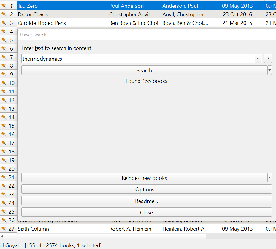

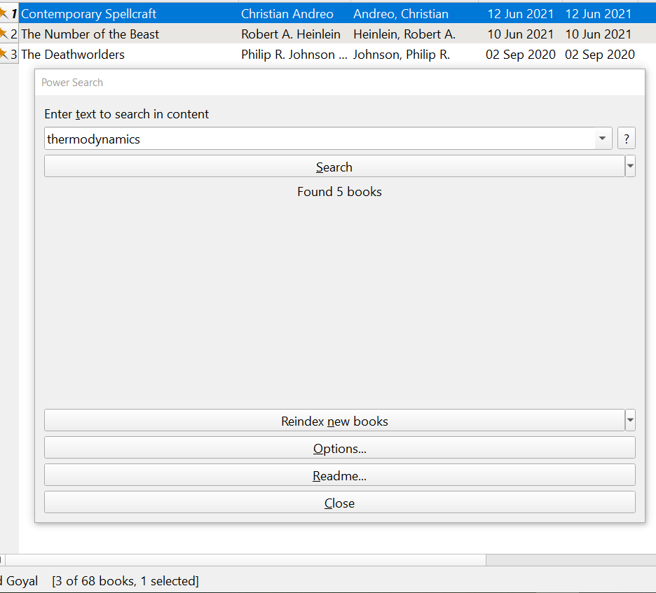

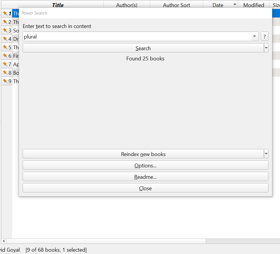

Currently using PowerSearch 2.1.0, 2021-Jun-16 with ElasticSearch 7.13.2. I have two libraries in use. I was seeing re-indexing issues on my Intake library plus weird book counts. I removed the indexes for both libraries and then rebuilt them and the issues seem to have disappeared. Note the images for my intake libraries were prior to doing the remove search index and full rebuild on both libraries.

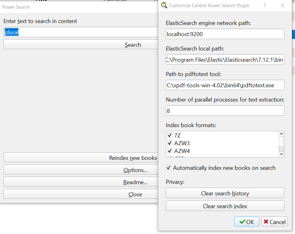

Originally Posted by Uncle Robin View Post
How do you remove the index?
Open Power Search, click on options, click on Clear search index, click on Yes. I repeated this for both libraries.

Thank you for your feedback, DNSB!
I guess I know what was happening. Prior to 2.1.0 the index of different libraries was not fully separated. Now once you run 2.1.0 for the first time the plugin will try to upgrade ElasticSearch index to the new "format", where every library has completely separate index. To do so, plugin will attach the index to currently selected library, therefore leaving the index for other libraries empty.
For people who were using only one library this upgrade won't be noticed. But the ones who were already using different libraries they might see some strange behavior.
Of course, full reindexing will fix this issue.
