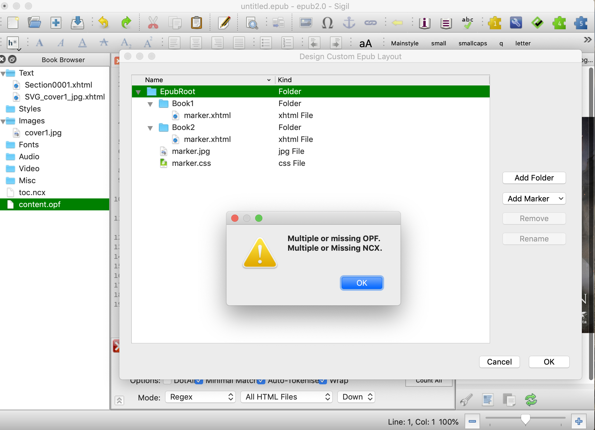

Just player a little bit around with the latest Sigil Version for Mac Kevin pm-ed to me. I tried the create enpty custom ebook but failed somehow, maybe i missed something or i'm doing something wrong, but the error message isn't very helpful.
As far as i understood i need to specify what filetype(s) a folder may contain, but after adding the markers the error message is complainng at i'm still getting an error message leaving me helpless (see attachment)
V

Adding markers for the OPF/NCX files is mandatory for EPUB2.

You are designing an empty epub. To do that you have to say where to put your OPF file and what to name it. Only 1 opf is allowed. Since you default to epub2, you also need to do the same thing for an NCX. Again only one NCX is allowed. In your case you do not have any of either required file.
The error messagesare quite clear, without an NCX and without an OPF you will not have a valid epub (empty or otherwise).
