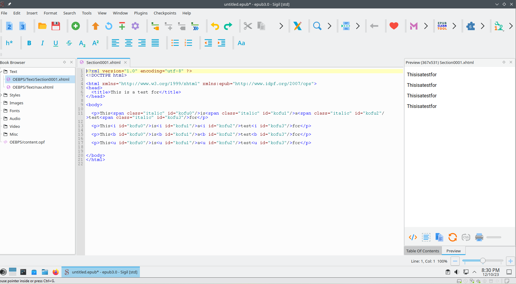

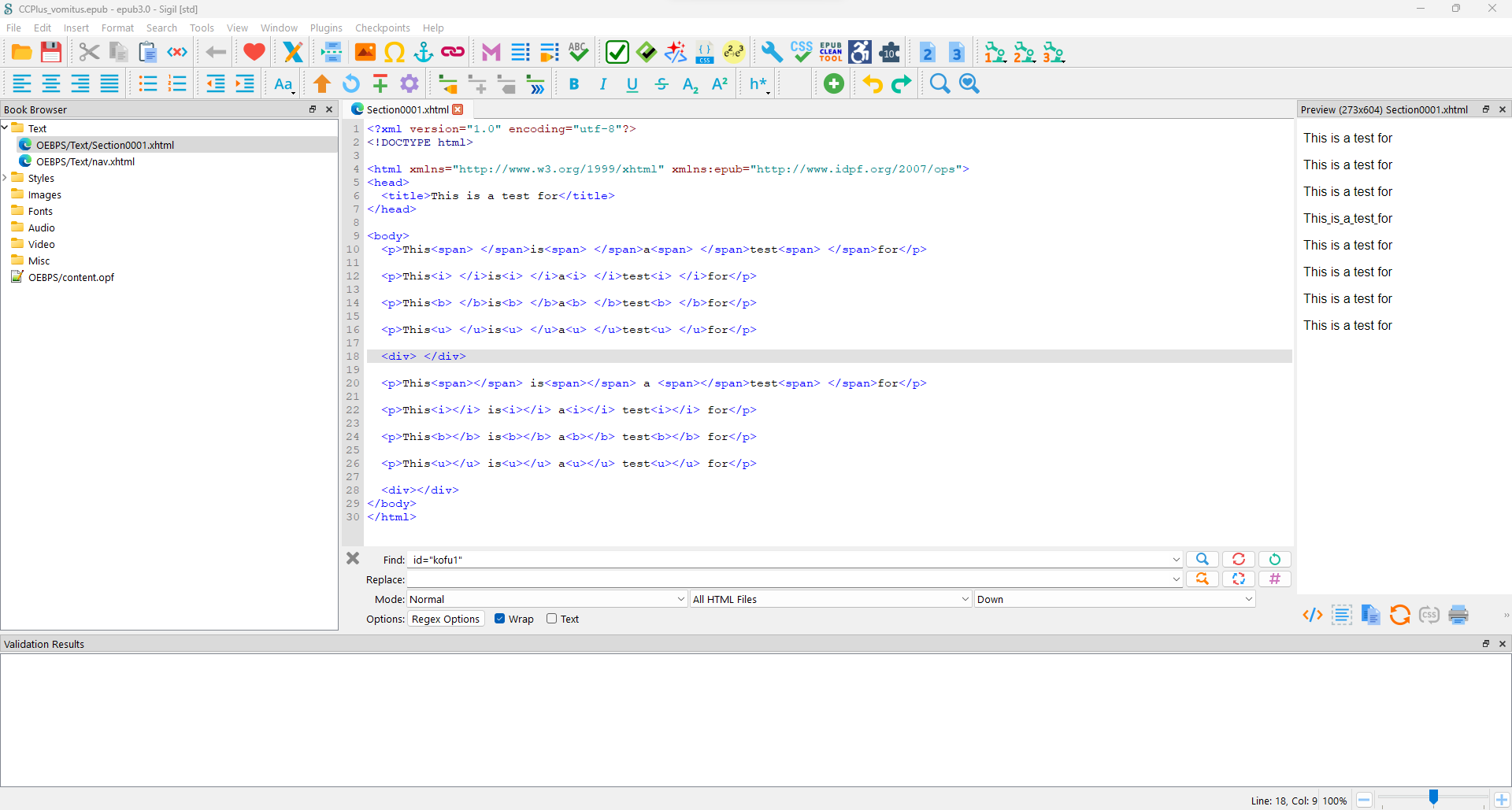

Old 12-10-2023, 03:02 PM   #190
Posts: 55,496
Karma: 182544230
Originally Posted by slowsmile View Post
@DNSB,
Well, for goodness sake, if you actually admit that styling a blank space using <span> tags is indeed a useless and pointless thing to do then why on earth are YOU doing that in your HTML code in Sigil and then insisting that it's a plugin problem?
It may be useless and pointless but the client's software is doing it. It is valid code that does not trigger epubcheck to throw any errors. Whereas your plugin converts word<i> </i>newword to wordnewword. Substitute any tag with or without a class/style/id/whatever. I noticed the issue when a final spellcheck barfed on the document.
I see this when I run CustomCleanerPlus on an epub all by itself after clicking clear all so no options are selected.
<p>This<span class="italic" id="kofu0"> </span>is<span class="italic" id="kofu1"> </span>a<span class="italic" id="kofu2"> </span>test<span class="italic" id="kofu3"> </span>for</p>
<p>This<span class="italic" id="kofu0"/>is<span class="italic" id="kofu1"/>a<span class="italic" id="kofu2"/>test<span class="italic" id="kofu3"/>for</p>
Preview before:
This is a test for
Preview after:
Thisisatestfor
I do have a search that looks for tagged space(s) and removes the tags but your code removes the space but not the tags which is wrong in so many ways.

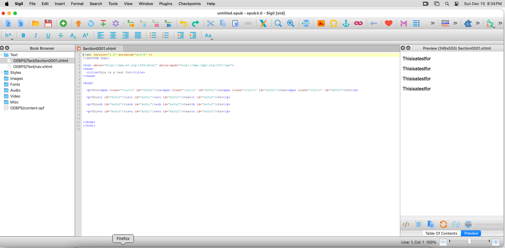

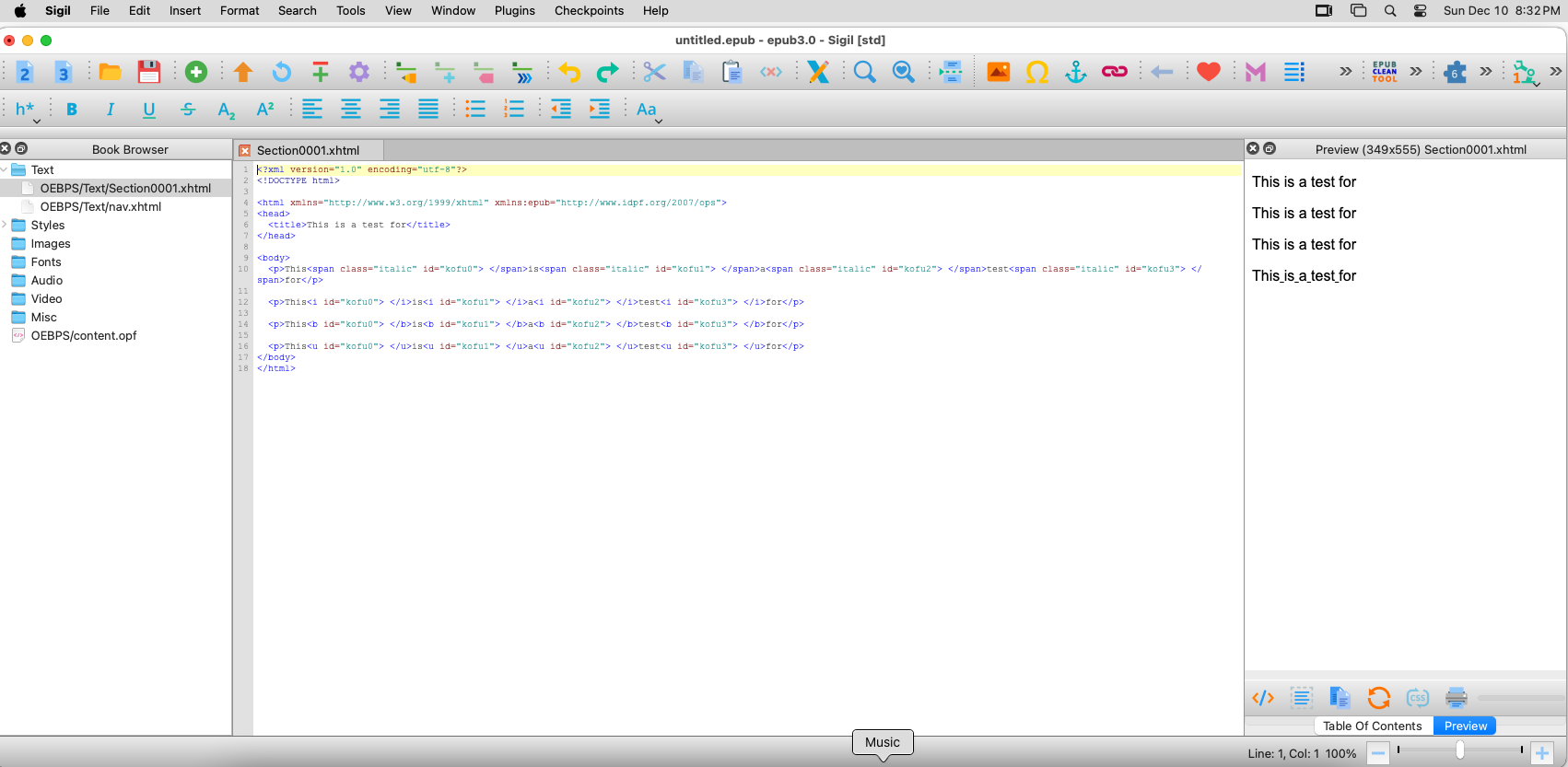

Old 12-11-2023, 12:49 AM   #193
Posts: 55,496
Karma: 182544230
For what it's worth, I updated to v0.5.5 when it was released. As part of my testing, I also spun up several virtual machines where I installed Sigil and CustomCleanerPlus v0.5.5. I saved an epub3 version of my test line. When I ran CustomCleanerPlus on my test epub, I got the same result on all 3. No other plugins were installed on those three VMs.
Please note that this behaviour is consistent with any of the tags I tested surrounding a space and even when I tried <div> </div> which was collapsed to <div/>.
See the attached images for the before (Mac OS Sonoma 14.1.2 only) and the post CCPlus run on all three VMs.
I still believe that removing the tags and leaving the spaces would be the correct behaviour while the actual behaviour of removing the spaces and collapsing the tags in incorrect.
ID:	205131   Click image for larger version
ID:	205132   Click image for larger version
ID:	205133   Click image for larger version

Just for the heck of it, I did a bit more testing by duplicating the content of the test epub, removing the classes and ids and moving the space outside the tags. Oddly, the results were pretty much the same, the tags were collapsed and not removed.
ID:	205135   Click image for larger version
