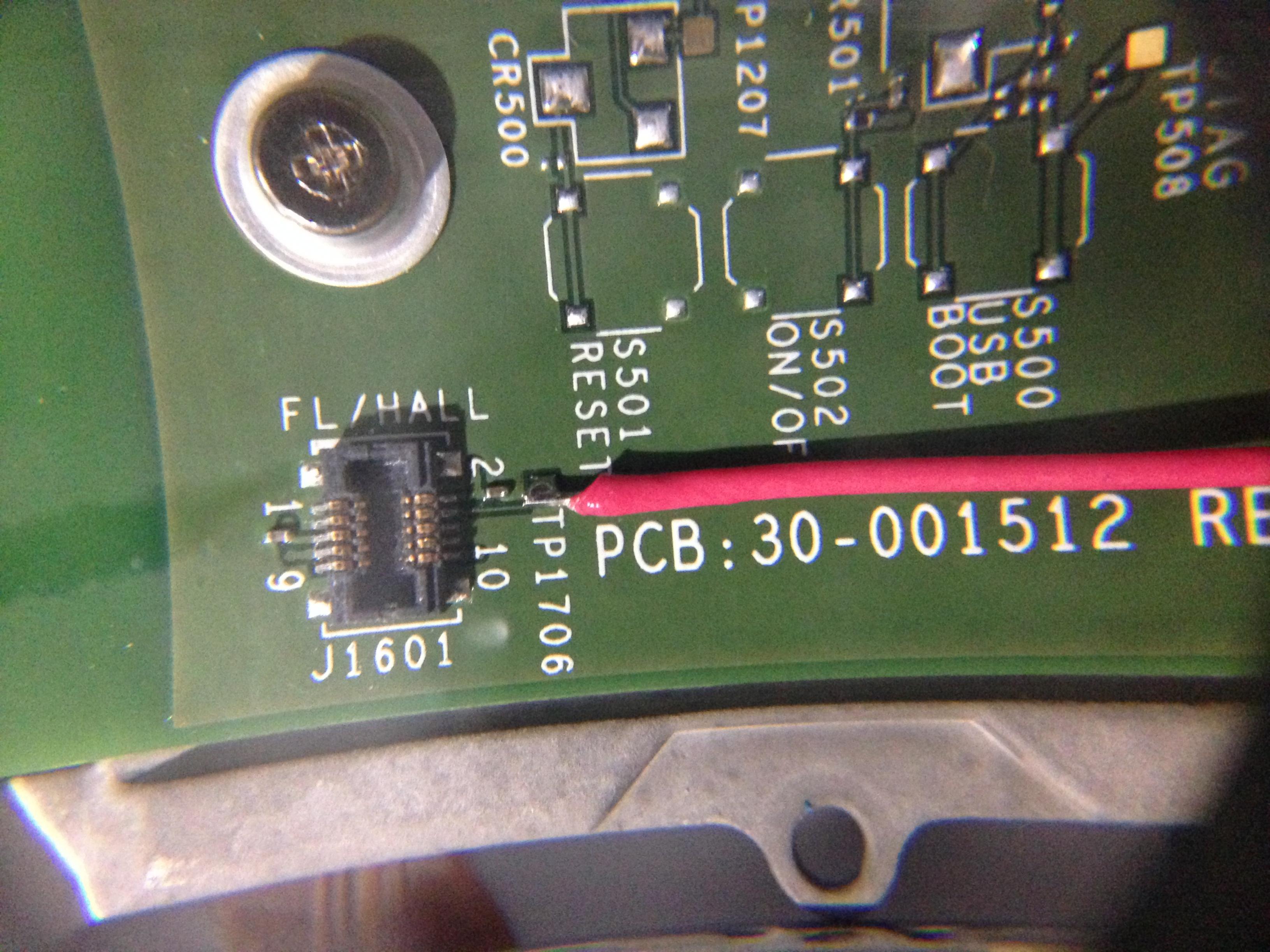

Hi, the 1.8v pad in the tutorial is dead on my PW3, It does not give a reference voltage. ( TP1706 )
There is another pad that give 1.65v, that I have soldered to, but I don't trust it :-)
The power button pad gives proper 1.8, but pulling that down to ground turns the kindle on/off.
I think I saw some people use a AA battery for the reference, if I do that, do I just hook Negative to ground, and the positive to the reference voltage on the serial board?
Any recommendations are appreciated.
Going from top to botom in my image:
1. GROUND
2. RX
3. TX
4. POWER hot
5. POWER gnd
6. 1.65 voltage that turns on when the device is running.
MY tracking number says I will get my serial board Thursday

Close.
A battery with Lithium/Iron Disulfide chemistry.
New ones have an open circuit voltage of 1.8 volts.
And your powering the CMOS reference input of the adapter, which is approximately zero load.
One example: Energizer Ultimate Lithium.
(in AAA and AA sizes).
That test point mentioned in the directions is part of the screen's front light circuitry.
Which I suppose you still have unplugged.
I really should go searching that motherboard for a better reference source - whenever the front light goes out, the adapter stops adapting.

Ah, that makes sense, I can hook in the FL/Hall cable, and that will probably activate that.
I do know that the on/off switch is always on, and bridging that to the ground does on/off functionality.
I wonder if that would work for the reference voltage on the ftdi chip, or will that try to turn it on and off all the time.
I won't know until Thursday :-)
