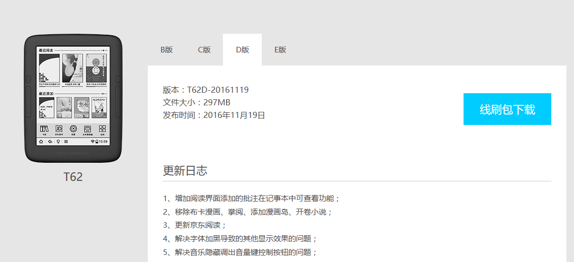

Originally Posted by tancbzero View Post
I click your link but it go to wap site . I did found fw
2017019916 but it is test fw, i not test update now because i don't have PC here.
In my boyue, i often use Alreader for prc, epub file, and perfect viewer for pdf. It have many customizations for me
I don't understand what you are talking about this is the page I get when I select D. And the blue button starts the download. As you can see it is
Version: T62D-20161119
File size: 297MB
Release time: November 19, 2016
File size: 297MB
Attachment 156154
Sorry, yesterday i don't have laptop,i did used smartphone go to link and it auto go to http://m.boyue.com/wap.aspx . Today i use laptop and i did see link download, thank you for support
