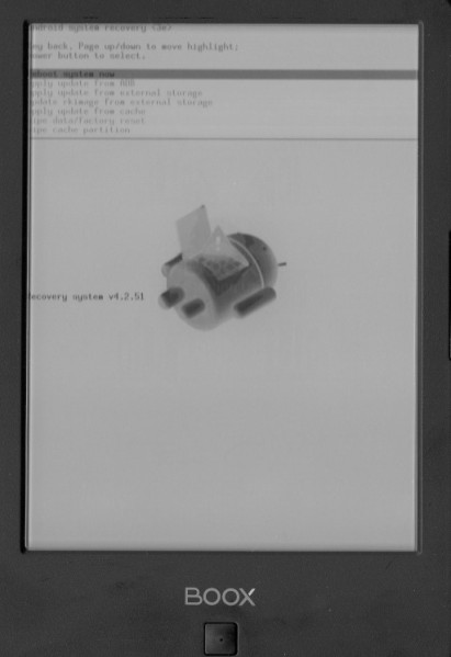

Recovery Mode Energy Sistem Pro?
Does anybody know how to get into Recovery mode with an Energy Sistem Pro device.
Holding both (power button and refresh button) is showing me the open lying robot but nothing else. I'm missing the options for recovery like shown in the attached pic from C67ML.
Would it be save to use a borrowed recovery.img from a C67ML device?
