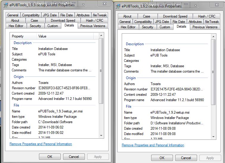

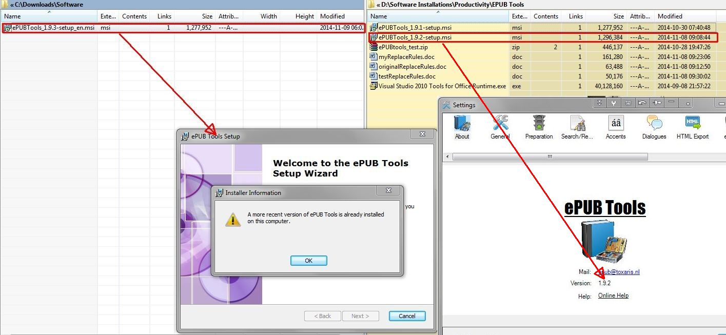

@Toxaris - I tried to install version 1.9.3 - I got what you see in first image attachment, second image shows Properties->Details for the two MSI's, file names are in title bar.
I could uninstall 1.9.2 I guess, but this didn't happen yesterday when I installed 1.9.2 over the top of 1.9.1, so that indicates something is not right.
I have also attached the installer log in a zip.
You are correct, I got the same message. Something strange with the installer I guess, although the creation of the installer is automatic. If you look at the log it actually says that its version is higher than the one installed. Somehow it thinks however it is lower.
Unfortunately you need to undelete 1.9.2 and install 1.9.3. Your settings will be retained if you uninstall normally.
No it doesn't, the only version mentioned is 1.9.0, and that's in relationship to what it is trying to install - the 1.9.3's only appear in the context of the name of the msi file - which can be anything. Now here's what I did:
I looked in the registry and 1.9.2 appeared where it should
HKEY_CURRENT_USER\Software\Toxaris\ePUB Tools\Path = C:\Program Files (x86)\Toxaris\ePUB Tools\
HKEY_CURRENT_USER\Software\Toxaris\ePUB Tools\Version = 1.9.2
HKEY_LOCAL_MACHINE\SOFTWARE\Microsoft\Windows\CurrentVersion\Installer\UserData\S-1-5-21-3755760686-4144392507-2264908130-1000\Products\DEBB102F7E49CDE4F9D6D8695BB08959\InstallProperties\DisplayVersion = 1.9.2
HKEY_LOCAL_MACHINE\SOFTWARE\Wow6432Node\Microsoft\Windows\CurrentVersion\Uninstall\{F201BBED-94E7-4EDC-9F6D-8D96B50B9895}\DisplayVersion = 1.9.2
I turned the registry inside-out, upside-down and shook-it-all-about - no sign of a 1.9.0 for anything
So I uninstalled 1.9.2 and installed ePUBTools_1.9.3-setup_en.msi,
Now where I previously saw 1.9.2 in the registry I see 1.9.0, and in the Control Panel->Programs & Features I'm informed I just installed 1.9.0. And when I look at C:\Program Files (x86)\Toxaris\ePUB Tools\ePUBTools.dll.manifest I see lines such as this
<assemblyIdentity name="ePUBTools" version="1.9.0.0" language="neutral" processorArchitecture="msil" />
The message that the Trusted Installer gave me was spot on. I was trying to install a product branded as "1.9.0" in the manifest, and that is where the Trusted Installer gets its information from, when I already had a later version, "1.9.2", installed. If you read the log carefully that's exactly what it tells us -
Windows Installer installed the product.
Product Name: ePUB Tools.
Product Version: 1.9.0.
Product Language: 1033.
Manufacturer: Toxaris.
Installation success or error status: 1603.
Yes, it would be better if it said "Windows Installer tried to install..." but I have a suspicion that not all 1603 error's are fatal.
When I look at version of the Epub Tools addin in Word it tells me it's 1.9.0 and it tells me that 1.9.3 is available...
I'm going to uninstall 1.9.whatever-it-is and reinstall 1.9.2 and await further developments.

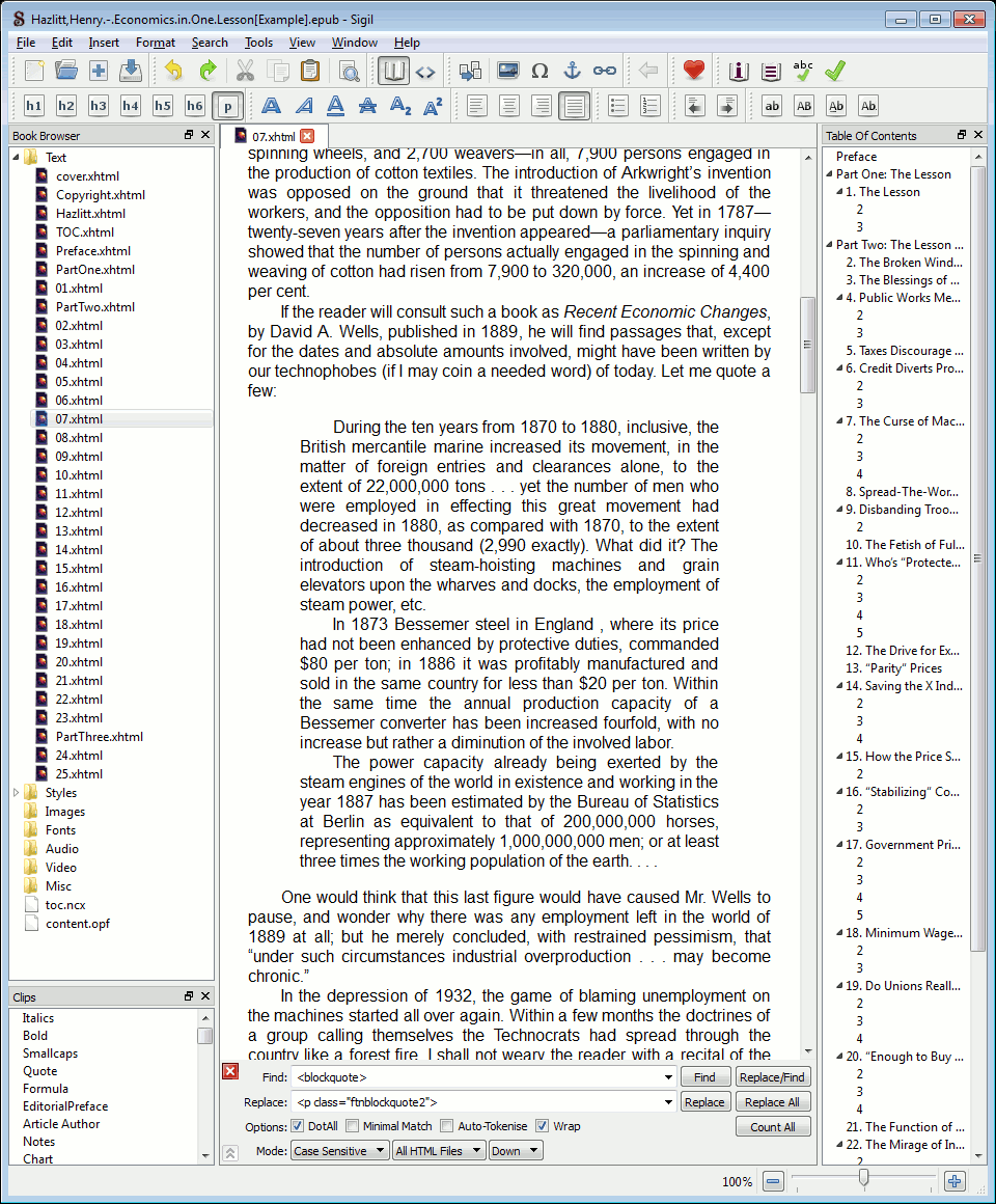

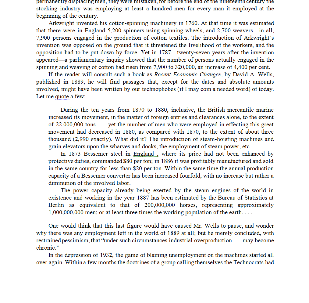

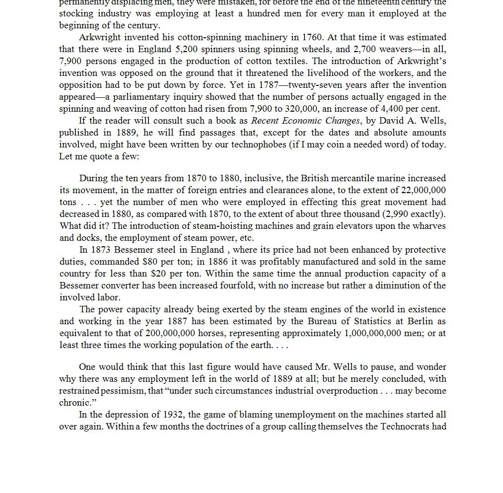

Old 11-09-2014, 07:03 PM   #195
Tex2002ans
Posts: 2,306
Karma: 13057279
Join Date: Jul 2012
Device: Kobo Forma, Nook
And just to specify exactly what I mean by left-margin blockquotes after import (I should have taken snapshots and done my usual, forgive me!).
EPUB in Sigil:

After Import using EPUB Import:
How I imagine it should look after EPUB Import:
As you can see, in the third image, the blockquote is much easier to spot when compared to the second.
