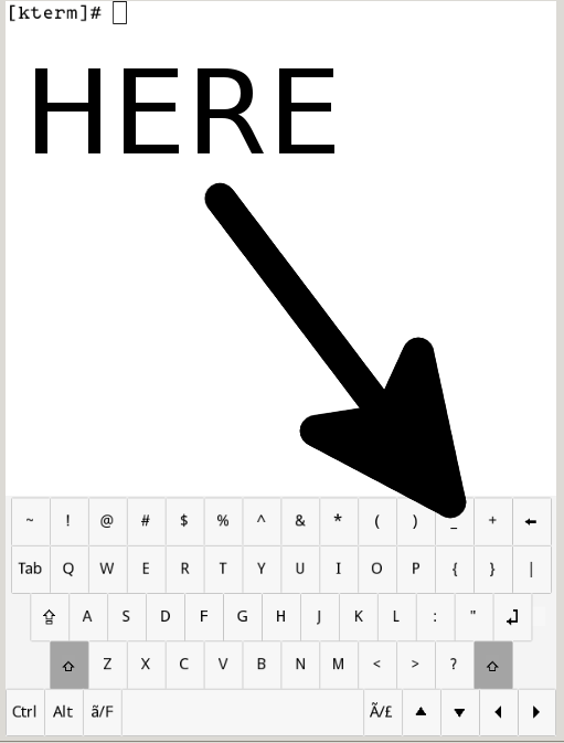

Originally Posted by nypaulie View Post
I tried using kterm to work with some png files in the screensaver folder (/usr/share/blanket/screensaver/), but kterm's keyboard is so tiny and I couldn't locate the underscore key.
On the paperwhite, there is an alternate set of keyboard files that give a lager 'key cap'
Also note that the key-mapping file was just updated this morning .
Is there in fact a key for the underscore character? I looked at all the key sets but could not find it.
Which key map file are you using (as in, post the link)?
Is that the most recent one nasser posted this morning?

right of the 0 (zero character)
when SHIFT is engaged.
(just like on a regular keyboard )
EDIT: Subtle picture attached

Thanks. Your mntroot rw info did it for me tho, so I can make my tweaks using KE instead. I am guessing the command "mntroot ro" will undo the access... I will give it a try so I don't mess up my PW.
