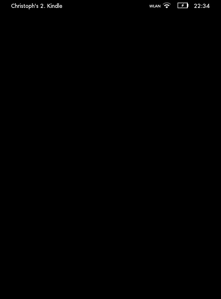

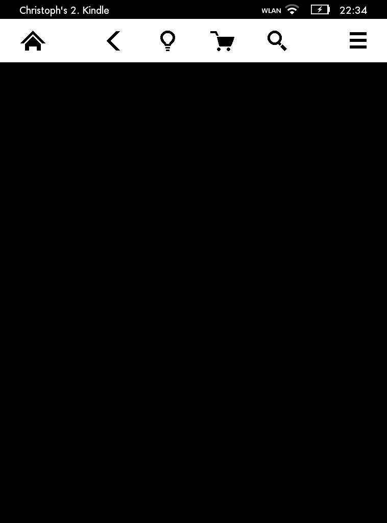

Device: Kindle Paperwhite
Yay, I have Debian on my Kindle.
(I chrooted Debian with qemu)
The only problem is that when I start launch-debian.sh that the coming screen stay black but the titlebar is available and I can press on it to open the extended titlebar to go home or somethings else.

Old 01-23-2013, 03:05 PM   #192
twobob
( ͡° ͜ʖ ͡°){ʇlnɐɟ ƃǝs}Týr
twobob's Avatar
Posts: 6,586
Karma: 6299993
Join Date: Jun 2012
apt-get install "something"
Mate I remember that you cant do screenshots easily... ??
But honestly a screen-shot would go a long to helping you now.
There is not much to see... but i upload it for you that you can see it.
Something will loaded but what would I see when it was successful?
Maybe the better question is how can I correct this mistake?

Old 01-23-2013, 05:54 PM   #194
twobob
twobob's Avatar
Posts: 6,586
Karma: 6299993
Join Date: Jun 2012
OOOh... errr... um... good question? thinking on that.
What would be the problem? Which part of matchbox is it and maybe I should apt-get update & upgrade? Don't know what is the problem there...
Maybe I should first think and then write my questions.
