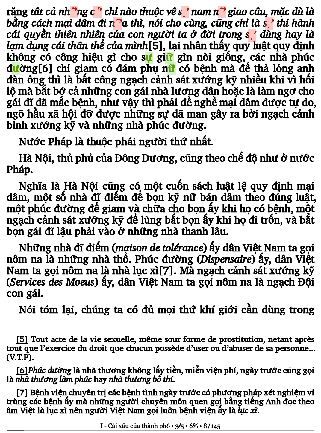

@JSWolf,
Thanks for your work on this. Love this font but I think just found a bug. I found the letter ư is not displayed in italic at all although all accompanying accent marks are. Please see the screenshot for what I meant. Rectangles in red are where it should be displayed in italic. Rectangles in green are where it's displayed up correctly in normal font.

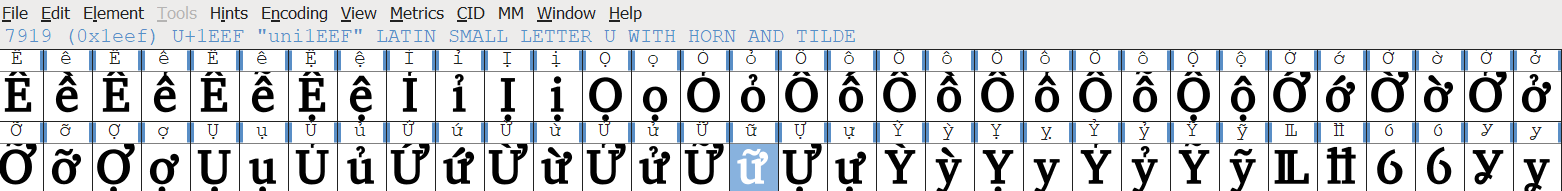

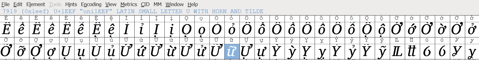

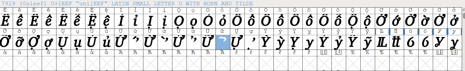

I used FontForge to take a quick look at Jon's ChareInk version of Charis SIL 5 in both the italic and regular version. As you can see from the attached image, the italic variant is missing all the accented lower case u with horns. This is corrected in the Charis SIL 6.101 version (see the third image).
I've been using the Charis SIL 6 with added weight and am quite happy with it.
