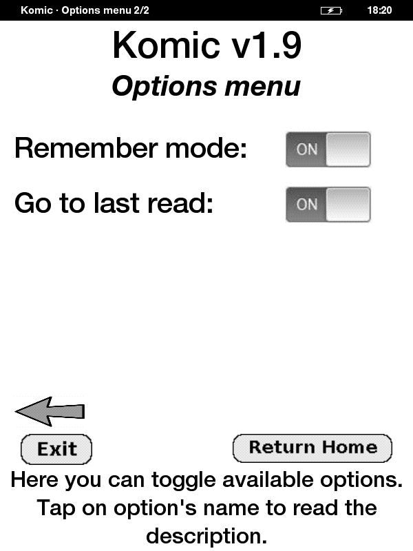

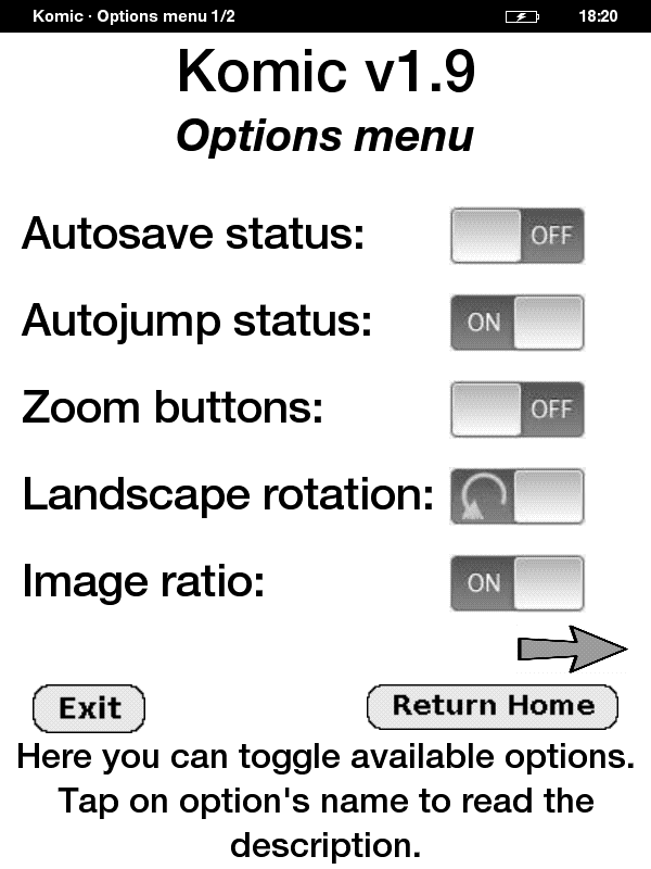

New options (and option pages!!):
ID:	92613   Click image for larger version

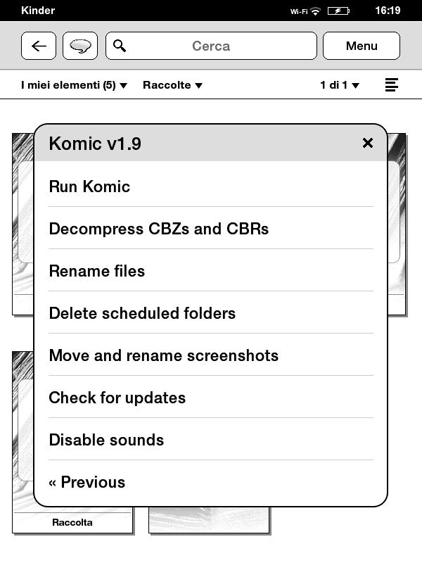

Few fixes done (smarter way of handling the new "go to last read" option + some improvements here and there).
And, what about a "Check for updates" feature???
I'm working also to make possible to download the update and install it...

Komic can now download and install updates by itself.
Use the "check for updates" script to check if a new version of Komic is out and, then, automatically download and install the update.
